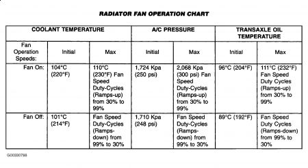

I noticed the radator fans were on while the vehicle was driving down the road. I was able to reset the computer and stop it by pulling off the negative battery cable. But the problem seems to have returned after a couple of weeks. The temperature gauge seems to be the same. What turns on the fans?
Nov 10, 2009 at 8:39 AM
DOCFIXIT
  • 18,828 POSTS
Three ways fan is turned on see chart
https://images.2carpros.com/forum/automotive_pictures/198357_Graphic_238.jpg

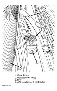

The relay maybe sticking closed see diagram
https://images.2carpros.com/forum/automotive_pictures/198357_Grafic_3_70.jpg
