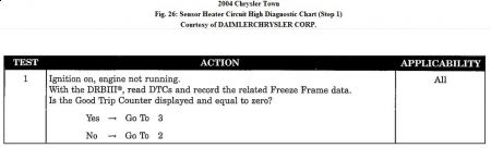

I have a 2004 Chy T&C, 3.8 liter. I had a bad sensor #1, I replaced both sensors. I still have a couple of codes p032 and P038. The heater circuit high volage on both sensors. From what i have read, this is related to a blown fuse or bad ground wire. I pulled every fuse under the hood and they all look good. I have not been able to locate any other fuse blocks.
1. Is this a fuse issue?
2. Where would the fuse be?
3. Any other toughts would be appreciated
At the same time this occured, the low beam onthe drivers side went out. I changestyhe light bulbs and the front control module to no avail. I do not know if they are related.

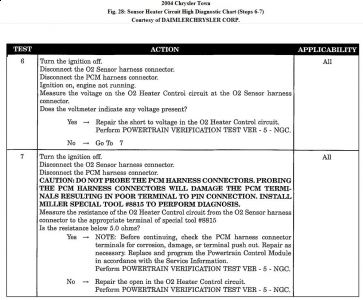

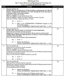

Hi dballard18, Thank you for the donation. Here is a description of the problem and diagnostics. Symptom List: P0032 -O2 SENSOR 1/1 HEATER CIRCUIT HIGH, P0038 -O2 SENSOR 1/2 HEATER CIRCUIT HIGH NOTE: All symptoms listed above are diagnosed using the same tests. The title for the tests will be P0032 -O2 SENSOR 1/1 HEATER CIRCUIT HIGH. When Monitored and Set Condition: P0032-O2 SENSOR 1/1 HEATER CIRCUIT HIGH When Monitored: Battery voltage above 10.6 volts, ASD is powered up, and O2 heater is off. Set Condition: Desired state does not equal Actual state. One trip fault. P0038-O2 SENSOR 1/2 HEATER CIRCUIT HIGH When Monitored: Battery voltage above 10.6 volts, ASD is powered up, and O2 heater is off. Set Condition: Desired state does not equal Actual state. One trip fault. POSSIBLE CAUSES O2 SENSOR HEATER OPERATION O2 HEATER ELEMENT O2 HEATER GROUND CIRCUIT OPEN O2 SENSOR O2 HEATER CONTROL SHORTED TO VOLTAGE O2 HEATER CONTROL CIRCUIT OPEN PCM
https://images.2carpros.com/forum/automotive_pictures/192750_HeaterSensor04TownFig26_1.jpg
https://images.2carpros.com/forum/automotive_pictures/192750_HeaterSensor04TownFig27_1.jpg
https://images.2carpros.com/forum/automotive_pictures/192750_HeaterSensor04TownFig28_1.jpg

For this particular vehicle there is also a known problem with many ECU firmware versions where neither replacing the O2 sensor nor clearing DTC codes, nor sucessful drive cycles can clear this error once it is set. It is true that the original factory oxygen sensors have a very low resistance when cold (4-8 ohms) while most replacement sensors are higher (10-20 ohms). Installing a currently available "genuine MOPAR" oxygen sensor (OEM Densu) or any other sensor with any chosen cold resistance will not resolve the problem. The code will always return after at least one drive cycle long enough to count followed an idle cycle long enough to cool the engine, followed by a drive cycle. The only resolution is to have a dealer reflash the engine firmware with a corrected version. There is a Chrysler Service Bulletin, however Chrysler is not offering this as a recall item.
With the engine off, disconnect the O2 sensor and check the O2 heater resistance is 20 ohms or less. Reconnect the )2 sensor leads and probe the heater leads with the engine running and verify that the O2 sensor heater is powered, and the ground lead is reasonably grounded. If these basic checks are good, the problem is likely to be the ECU firmware. Some dealerships insist on installing MOPAR 02 sensor(s) for several hundred dollars as a first step. Some dealerships charge $100 to $150 to diagnose and update the ECU firmware. Some dealerships accept the 3rd party diagnosis and the Service Bulletin and perform this brief (10 minute) chore for a fee more likely to encourage your continued patronage.
