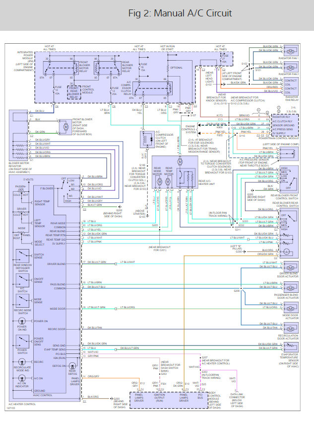

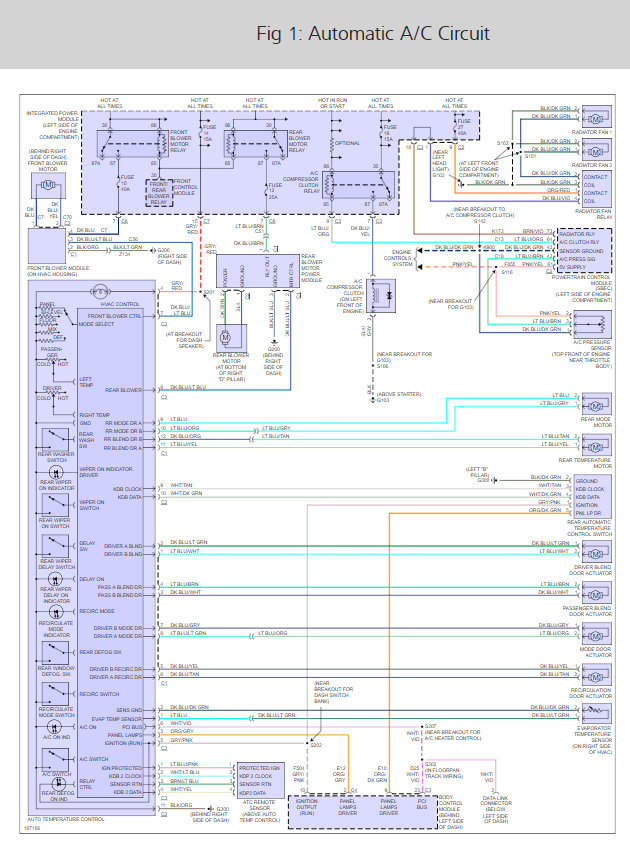

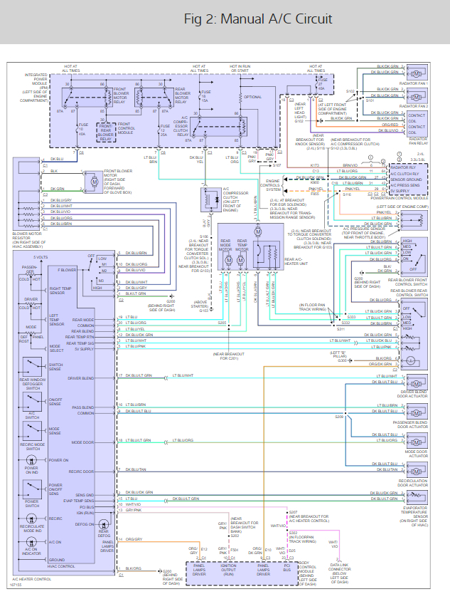

Fan blower switch will only operate on the high setting?
Dec 6, 2008 at 8:54 AM
OBXAUTOMEDIC
  • 3,711 POSTS
Hi Eddie,

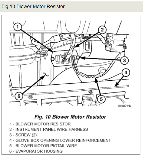

Sounds like your blower motor resistor and I believe that one in located in the duct work under passenger dash, but to be sure lets test thought he resistor using this guide because I have seen the switch go bad on these cars as well.
Here are the blower motor wiring diagrams along with the resistor location. Check out the diagrams (below). Please let us know what you find. We are interested to see what it is.

I tried the resistor but it did not help. Ao I did the switch next that took care of the problem. All fixed, I love this site.
