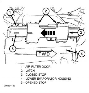

Have 2004 T&C Platinum. Is there an air cabin filter on this model? if so, where specifically and how do i replace?

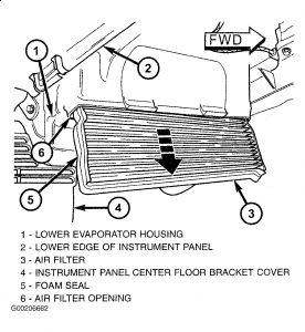

Hello, Locate the air filter door on the bottom of the lower HVAC housing just outboard of the passenger side of the instrument panel center stack.

Here is a guide to help you see what you are in for when changing the filter out https://www.2carpros.com/articles/how-to-change-an-air-cabin-filter Please let us know what happens. Cheers

Thanks for quick reply, is this diagram behind something, behind the center stack wrap around? Am I making sense? what do i need to remove to get to this? thank you

Is is located under the dash on the passenger's side in the HVAC housing.
