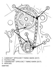

Needs timing diagram for the timing chain
Jun 22, 2010 at 9:56 AM
DOCFIXIT
  • 18,828 POSTS
Hows this
