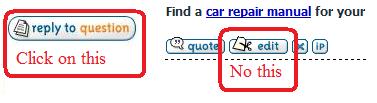

If you edit your post, we won't see your "reply". In the future,
https://images.2carpros.com/forum/automotive_pictures/55316_reply_1.jpg
