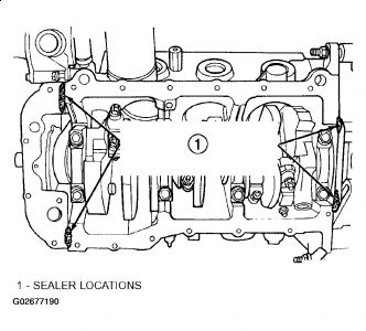

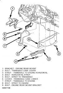

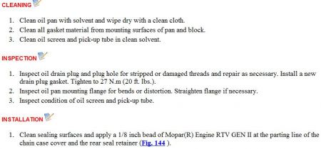

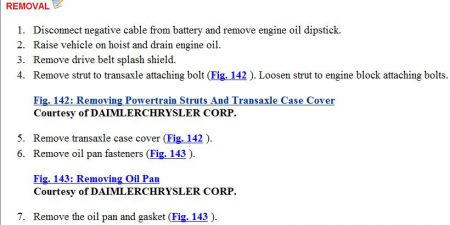

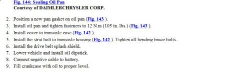

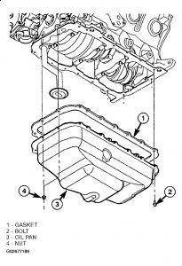

I have a gasket and some gasket sealer. I have looked at the pan and it looks as easy.
Is there any thing that will cause me trouble

I don't think so.
https://images.2carpros.com/forum/automotive_pictures/55316_02caravanoilpan1_1.jpg
https://images.2carpros.com/forum/automotive_pictures/55316_02caravanoilpan2_1.jpg
https://images.2carpros.com/forum/automotive_pictures/55316_02caravanoilpan3_1.jpg
https://images.2carpros.com/forum/automotive_pictures/55316_02caravanfig142_1.jpg
https://images.2carpros.com/forum/automotive_pictures/55316_02caravanfig143_1.jpg
https://images.2carpros.com/forum/automotive_pictures/55316_02caravanfig144_1.jpg
