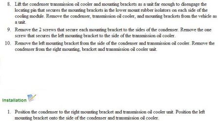

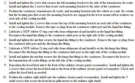

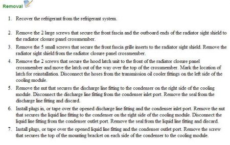

Local dealer wants $900= to replace the a/c condenser. Can I do this myself at home? I can get a condenser for $200.
