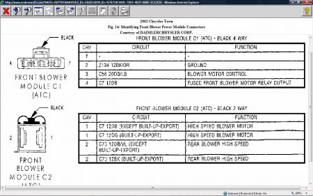

Front Blower Motor Inoperative
1.With the DRBIII(R) in FCM, read the active DTCs. If there are any active FCM DTCs present that are related to the blower relay circuits, refer to the manual temperature control section of the DIAGNOSTIC TROUBLE CODE IDENTIFICATION table. For all other FCM DTCs, refer to the DIAGNOSTIC TROUBLE CODE IDENTIFICATION table. See DIAGNOSTIC TROUBLE CODE IDENTIFICATION table. With the DRBIII(R), reset the ATC after repair/replacement is complete. If there are no active FCM DTCs present, go to the next step. 2.Turn the ignition off. Remove and inspect Intelligent Power Module (IPM) Fuse No. 10. If the fuse is open, go to the next step. If the fuse is not open, go to step 6. 3.Replace IPM Fuse No. 10. Turn the ignition on. Operate the blower motor in all speeds. Start the engine and operate the ATC system in all modes and speeds. If the blower motor operates properly without blowing the fuse, refer to the wiring diagrams to help isolate a possible intermittent short to ground condition. See WIRING DIAGRAMS. With the DRBIII(R), reset the ATC after repair/replacement is complete. If the blower motor does not operate properly without blowing the fuse, go to the next step. 4.Turn the ignition off. Disconnect the Front Blower Power Module C1 harness connector. See Fig. 14. Measure the resistance between ground and the Fused Front Blower Motor Relay Output circuit. If the resistance is below 10K ohms, repair the Fused Front Blower Motor Relay Output circuit for a short to ground. Replace IPM Fuse No. 10. With the DRBIII(R), reset the ATC after repair/replacement is complete. If the resistance is above 10K ohms, go to the next step. 5.Turn the ignition off. Replace IPM Fuse No. 10. Disconnect the Front Blower Power Module C1 harness connector. Disconnect the Front Blower Power Module C2 harness connector. See Fig. 14. Connect a jumper wire between the Fused Front Blower Motor Relay Output circuit in the Front Blower Power Module C1 harness connector and the Dark Blue wire in the Front Blower Power Module C2 harness connector. Connect a jumper wire between the Ground circuit in the Front Blower Power Module C1 harness connector and the Dark Blue/Yellow wire in the Front Blower Power Module C2 harness connector. Turn the ignition on. If the Blower Motor operates at full speed without blowing the fuse, replace the Front Blower Power Module. See appropriate AUTOMATIC A/C-HEATER SYSTEMS article in HVAC. Replace IPM Fuse No. 10. With the DRBIII(R), reset the ATC after repair/replacement is complete. If the Blower Motor does not operate at full speed without blowing the fuse, replace the Blower Motor. See appropriate AUTOMATIC A/C-HEATER SYSTEMS article in HVAC. Replace IPM Fuse No. 10. With the DRBIII(R), reset the ATC after repair/replacement is complete.
NOTE: The test light must illuminate brightly. Compare the brightness to that of a direct connection to the battery.
6.Ensure IPM Fuse No. 10 is installed. Disconnect the Front Blower Power Module C1 harness connector. See Fig. 14. Turn the ignition on. Using a 12-volt test light connected to ground, back probe the Fused Front Blower Motor Relay Output circuit in the Front Blower Power Module C1 harness connector. If the test light illuminates brightly, go to the next step. If the test light does not illuminate brightly, go to step 13. 7.Turn the ignition off. Disconnect the Front Blower Power Module C1 harness connector. See Fig. 14. Measure the resistance between ground and the Ground circuit. If the resistance is below 5

Fig. 14: Identifying Front Blower Power Module Connectors
Courtesy of DAIMLERCHRYSLER CORP.
