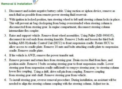

2001 Chrysler Town and Country REPAIR OF RACK AND PINION
2001 CHRYSLER TOWN AND COUNTRY
100,000 MILES • 6 CYL • FWD • AUTOMATIC
STEVE VANTINE
HOW TO UNBOLT AND REMOVE
Jun 28, 2010 at 3:21 PM
BLUELIGHTNIN6
  • 16,542 POSTS
https://images.2carpros.com/forum/automotive_pictures/261618_Noname_2389.jpg
