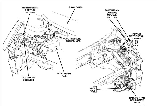

Yesterday my engine light came on our 2000 minivan, 3.3 engine. We got a code of P1491 indicating a radiator fan relay circuit condition. The car overheated as a result on the wife's return home from work. She turned on the heat and the overheating was abated temporarily. Where can we start to check for the problem? I checked the relays and fuses near the battery and there is no fan relay circuit. I see a blower motor relay. I also see a "rad fan" 40v fuse which looks difference from the rest of the 40's. Where is the radiator fan relay located in the mini-van? Your assistance is greatly appreciated. Ron N. Johnson,
Jul 25, 2009 at 4:54 AM
  • 55,423 POSTS
The radiator fan control relay is solid start and is located down on the core support near the radiator on the drivers side. Here are some diagram so you can see for yourself. (Below)

My Radiator cooling fans stay on, even when the ignition is off. We put a diagnostic scanner on the vehical and recieved a DTC P1491 "Fan Relay Circuit Fault"
I can't locate the "Relay" for the Radiator cooling fans

WRENCHTECH
  • 20,761 POSTS
This is not your normal relay. It is a solid state relay and it's mounted to the inside of the frame in the front driver's side, near the radiator.

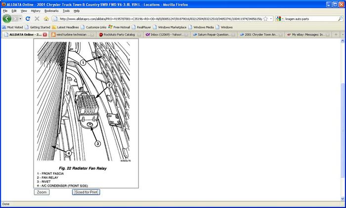

Is there any pictures/diagrams of the location of the radiator fan relay on my 2001 Chrysler Town & Country Limited 3.8 liter van?? Or explain in detail how to get to it. I can not find it!!!! HELP!!
Oct 12, 2017 at 1:05 PM (Merged)
SATURNTECH9
  • 30,869 POSTS
It's behind the grill i posted a diagram to show you where it is.

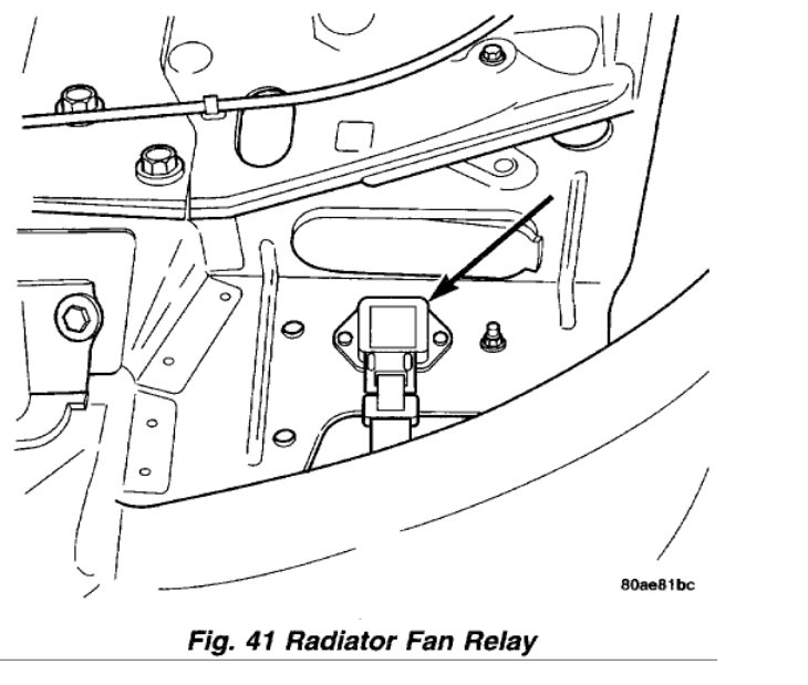

BMRFIXIT
  • 19,053 POSTS
Coolant fan relay is located behind the grille on front bumper reinforcement

JSGGIB88
Engine Cooling problem
1998 Chrysler Town and Country 6 cyl Two Wheel Drive Automatic
the radiator fan relay is not working but i can not locate it to replace it any idea where it might be hiding

  • 75,992 POSTS
See location below:
