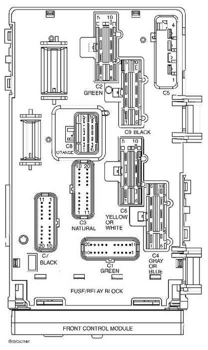

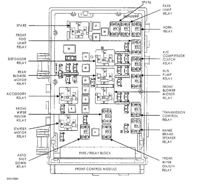

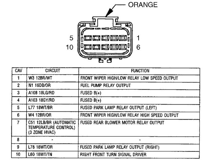

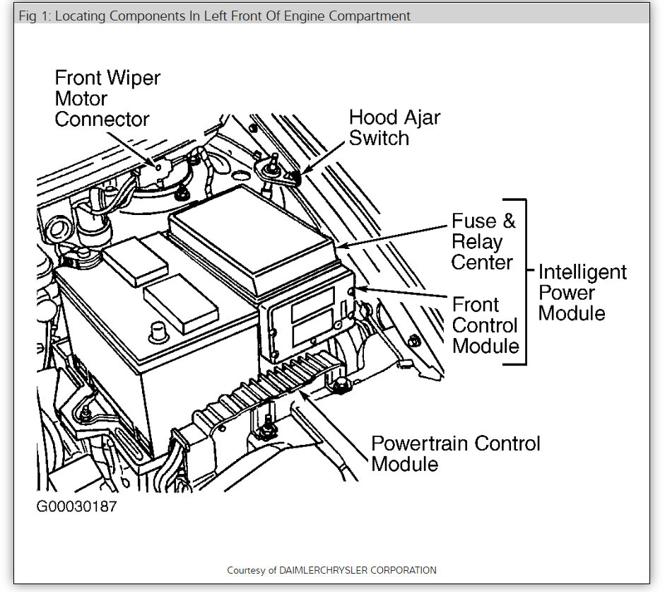

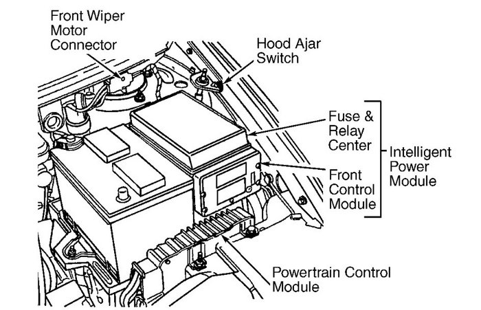

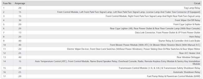

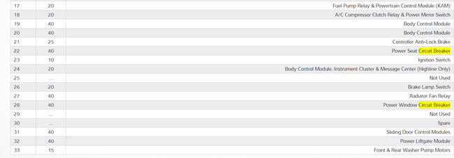

i cant find the fuse panel in the van.i have found the relay switches. where is the panel located?
Jun 30, 2008 at 10:05 AM
  • 75,988 POSTS
Here is a guide to help check the fuse with the fuse panel identification and locations below:
Jun 30, 2008 at 12:46 PM

* upon trying to crank the van I get a fast clicking noise that seems to be comming from the ASD relay in the fuse panel. Weirdly enough it still clicks after pulling the key out of the ignition, I have to remove the negative batt cable to stop it. rechecked all my connections, everything is solidly in place and where it should be. Tried reconnecting the old wires/coil pack because at least then I could start the van, but now I have the same problem with that setup. As far as I can tell, the system isnt even going as far as the coil pack because I get the same clicking noise with no harness connected to the coil pack.

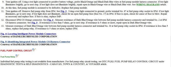

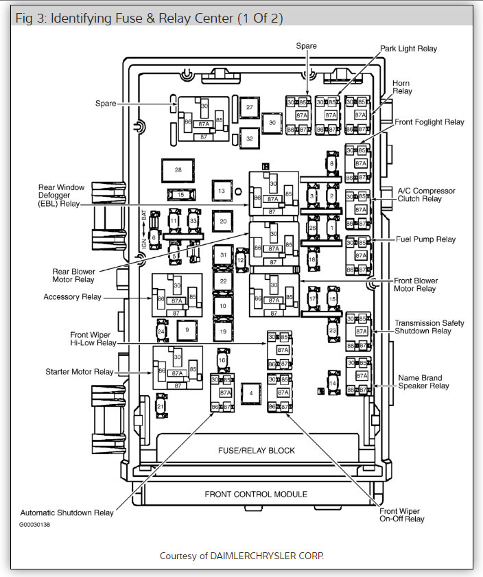

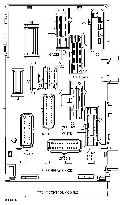

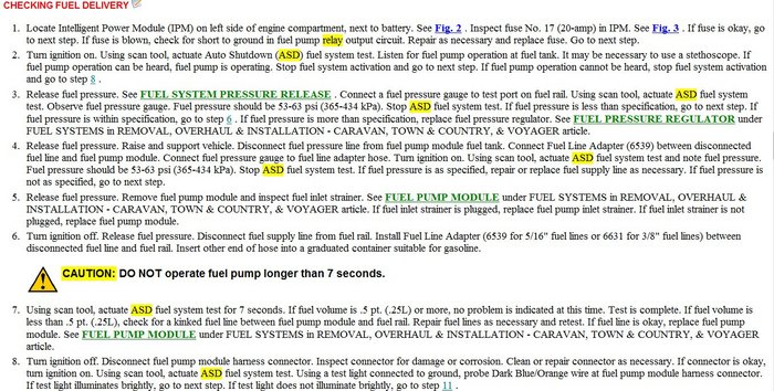

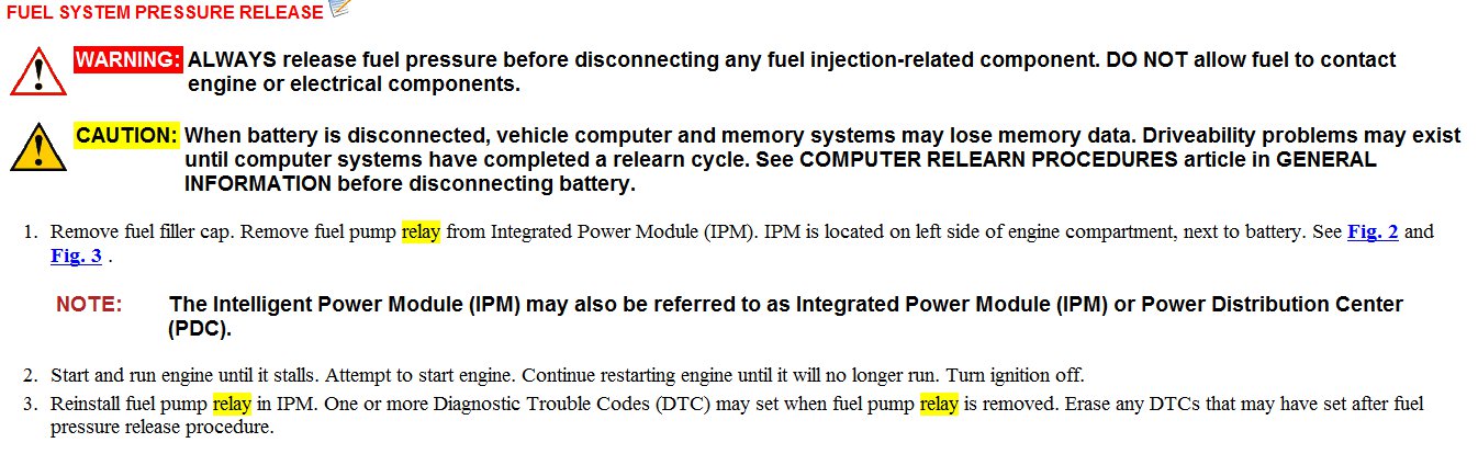

I am providing you with fuel sytem tests. The Intelligent Power Module, IPM, contains the ASD Relay and is integrated into it. The fuel pump relay is not integrated and can be replaced. Hopefully it is the fuel pump relay. I think one of the 2 was the issue from the start as the fuel pressure would be irratic and cause the symptoms you are having. When the test refers to using a stethospce to hear the fuel pump, you might be able to get away with having someone place a large flate blade screwdriver on the side of the tank as near the fuel pump. When the ignition is turned to the, "ON" position the pump primes the system by running for about 2 seconds. you are listening for a, "whirring" noise.
I had to break fuel or IPM/ASD test into 2 parts labeled 1of2 and 2of2. All the figuers from tests are labeled as such.
You can also have the trouble codes pulled if all of testing fails at any Advance Auto or Auto Zone for free. You can also get fuel pressure test kit with adapters at either store on loaner basis.
I hope everything works out for you.
