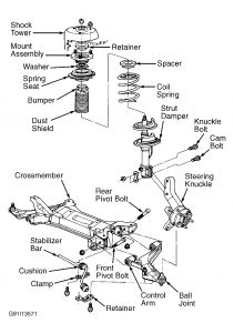

Suspension problem
2001 Chrysler Town and Country 6 cyl Front Wheel Drive Automatic
How do I replace the Front Stabilizer Bar Bushings
Nov 7, 2008 at 4:24 AM
BMRFIXIT
  • 19,053 POSTS
Raise and support the van locate stabilizer bar It has two bolts and nuts on it on each side remove both sides and replace bushing no need to remove links need manual CHECK IT @ https://www.2carpros.com/kpages/auto_repair_manuals.htm
