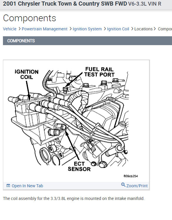

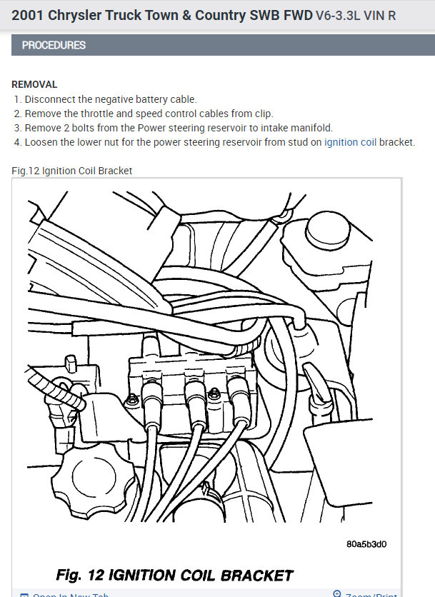

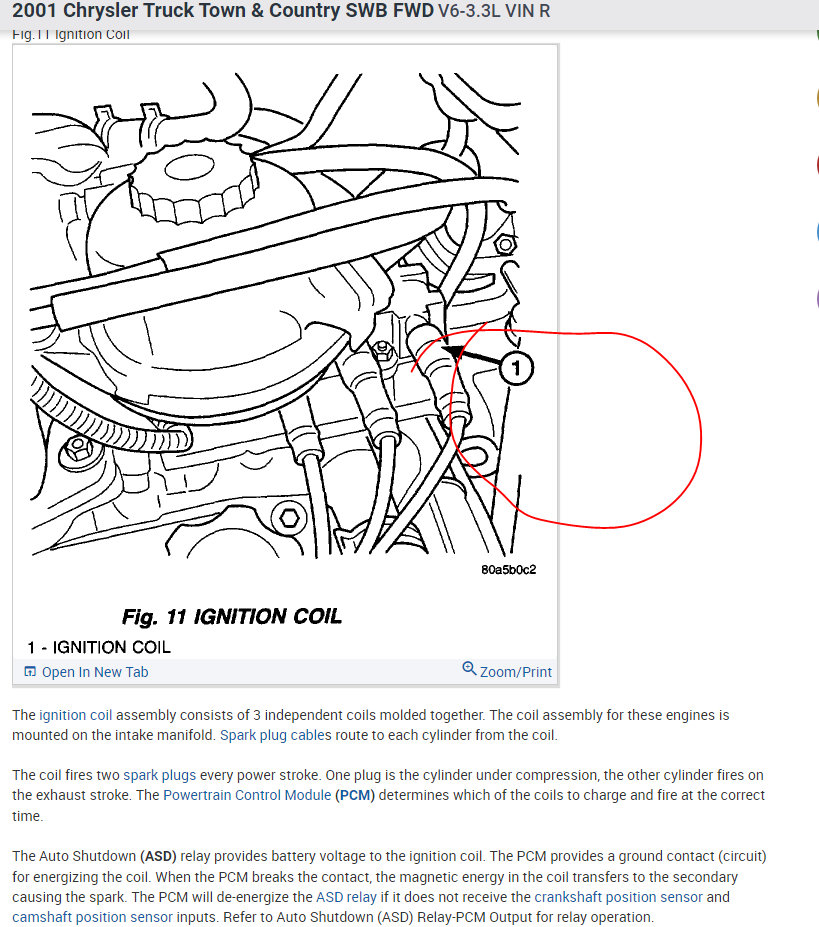

How can i remove the coil pack to replace it. It is located under the power steering fluid container and I am having difficulty getting to it. Please help
Jun 19, 2008 at 9:57 AM
SQM
  • 6,383 POSTS
On this vehicle you will have to remove those 2 bolts for the power steering reservoir and move it out of the way, then you will be able to access the ignition coil.
Be sure to disconnect the negative battery cable before getting started.
I have attached replacement diagrams for your reference.
