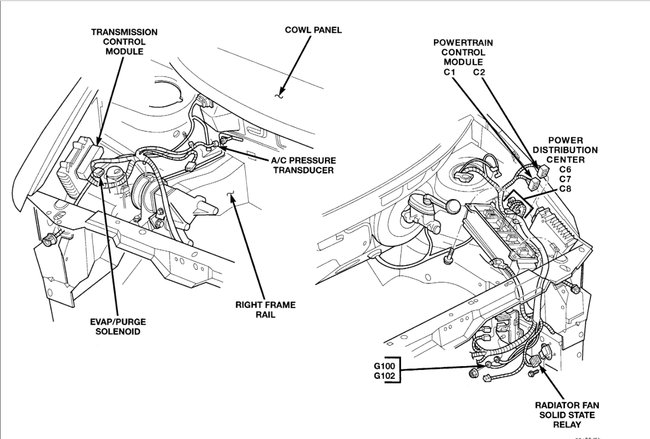

Yesterday my engine light came on our 2000 minivan, 3.3 engine. We got a code of P1491 indicating a radiator fan relay circuit condition. The car overheated as a result on the wife's return home from work. She turned on the heat and the overheating was abated temporarily. Where can we start to check for the problem? I checked the relays and fuses near the battery and there is no fan relay circuit. I see a blower motor relay. I also see a "rad fan" 40v fuse which looks difference from the rest of the 40's. Where is the radiator fan relay located in the mini-van? Your assistance is greatly appreciated. Ron N. Johnson,
Jul 25, 2009 at 11:54 AM
  • CAR REPAIR CONTRIBUTOR
  • 54,193 POSTS
The radiator fan control relay is solid start and is located down on the core support near the radiator on the drivers side. Here are some diagram so you can see for yourself. (Below)

THIS IS A "LX"
IF THESE ARE WRONG, LET ME KNOW WHAT MODEL YOU DO HAVE AND I'LL TRY AGAIN

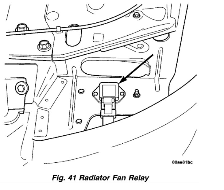

2000 Chrysler Town and Country 6 cyl Front Wheel Drive Automatic 122268 miles
My Radiator cooling fans stay on, even when the ignition is off. We put a diagnostic scanner on the vehical and recieved a DTC P1491 "Fan Relay Circuit Fault"
I can't locate the "Relay" for the Radiator cooling fans
Does anyone know where it would be...

This is not your normal relay. It is a solid state relay and it's mounted to the inside of the frame in the front driver's side, near the radiator.
https://images.2carpros.com/forum/automotive_pictures/561653_Cooling_fan_relay_00_T_and_C_1.jpg

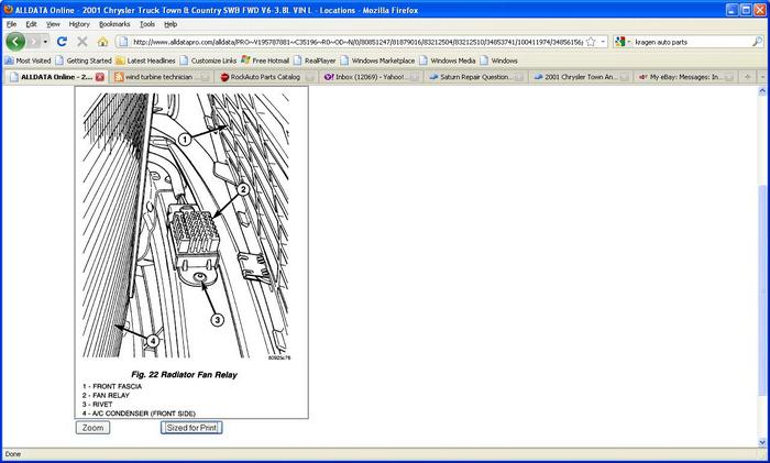

Is there any pictures/diagrams of the location of the radiator fan relay on my 2001 Chrysler Town & Country Limited 3.8 liter van?? Or explain in detail how to get to it. I can not find it!!!! HELP!!
Oct 12, 2017 at 8:05 PM (Merged)
SATURNTECH9
  • 30,869 POSTS
It's behind the grill i posted a diagram to show you where it is.

2001 Chrysler Town and Country 6 cyl Front Wheel Drive Automatic 88,000 miles
Oct 12, 2017 at 8:06 PM (Merged)
BMRFIXIT
  • 19,053 POSTS
Coolant fan relay is located behind the grille on front bumper reinforcement
