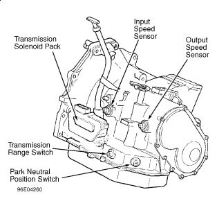

Need to run code check suspect speed sensors input or output and or tranny solenoid pack \ good luck
https://images.2carpros.com/forum/automotive_pictures/99387_Graphic9_40.jpg
