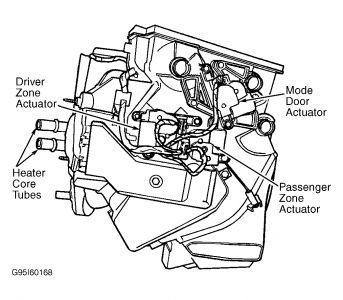

Pass side vents, floor, dash and windshield do not blow hot air , only cold. Driver side vents work fine. Rear air (heat) works fine also. Pass side thermal control appears to have no effect on warming. What could cause this and how is it fixed?

Looks like your dual mode blending door actuators is not working properly.
https://images.2carpros.com/forum/automotive_pictures/55316_tcblenddoor_1.jpg
This is probably not something that DIY should attempt. Repair requires the removal of ABS module, calibration of the blending door system, and installation/bleeding of the ABS module which can only be done with a scan tool capable of ABS.
