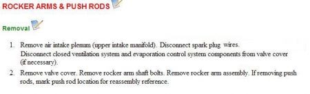

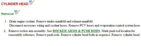

1998 dodge caravan 4 cyl Two Wheel Drive Automatic
cant get the head off...the timing belt and cover seem to be holding me in...do i need to put the engine on jacks

does this help?..
https://images.2carpros.com/forum/automotive_pictures/261618_Noname_670.jpg
https://images.2carpros.com/forum/automotive_pictures/261618_Noname2_169.jpg
