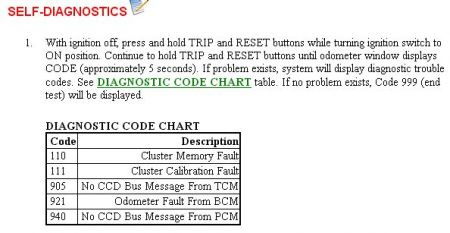

My daughter left the key in the on position all day and the battery went dead. My neighbor hooked the battery to the battery charger and we got the car started. Now the low beams, power locks, remote entry and part of the computer center (fuel economy and distance to empty info) not working. We have checked the fuses and the relay's with no luck. Any clue what to do next? Thanks for your help.

You may need to have some reprogramming done, sounds like a communication error. Try this test and let me know what happens:
https://images.2carpros.com/forum/automotive_pictures/30961_Image1_2.jpg
