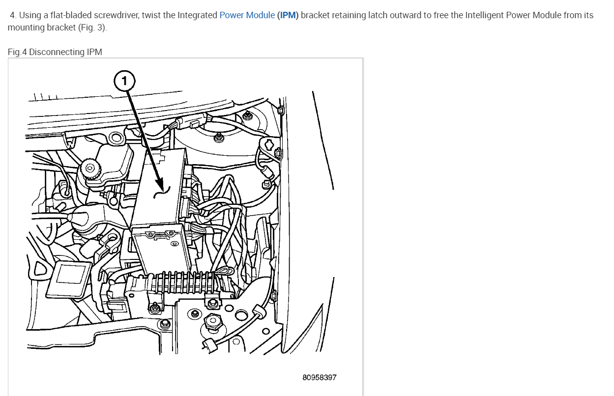

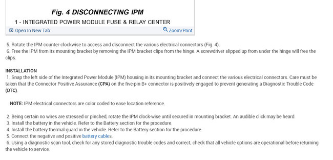

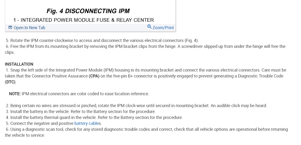

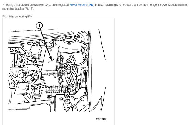

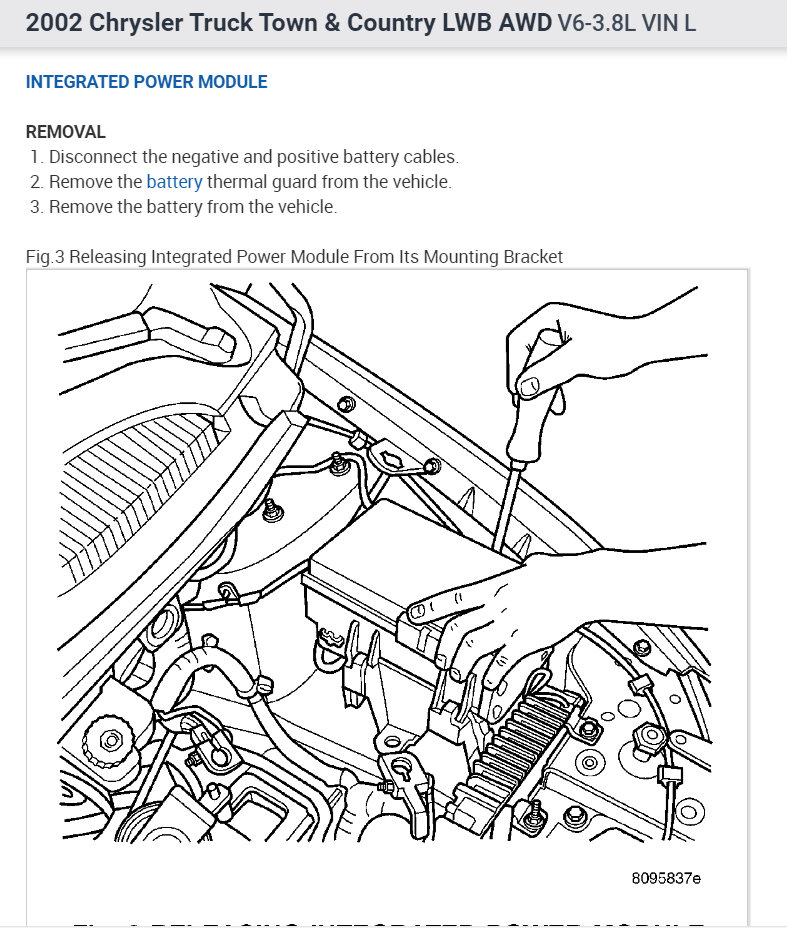

Driving to work, when the radio and dash lights stopped working. Stopped to ck Lights, they don't week either. The Just made it back home, but along the way, I noticed( ABS) LIGHT On the transmission started to act up, the tachometer started to go up and down. After I barely made it home, I turned the engine off and tried to start it it won't start. Have had No problem starting before. Its a New Batt.I have no clue, can someone HELP.

It is common for the IPM to go out in these cars but fear not, it is easy to replace just follow the instructions below, it self initializes so there is not programming involved. Check out the diagrams (Below). Please let us know if you need anything else to get the problem fixed.
