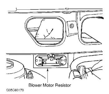

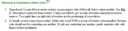

I have a heater control with rear air, the front air control works only when on high. I have a new resistor for the fan which I bought after replacing the fan control module. Where will I find the fan resistor to replace it? There is anther problem with the electrical. When I start the vehicle the instrument cluster goes blank for awhile. After a half hour or more with the motor running the instruments come back on. Any ideas?

As for the blower resistor, below are removal/installation instructions along with the location of the component.
https://www.2carpros.com/forum/automotive_pictures/261618_Noname_101.jpg
FIGURE 5
https://www.2carpros.com/forum/automotive_pictures/261618_fig_3.jpg
Hope this helps..
