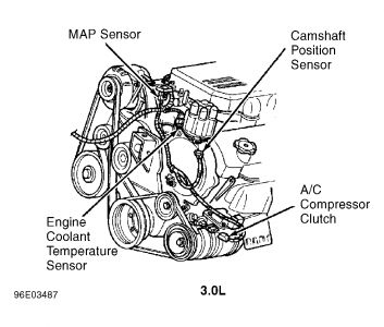

Where is the water temp. sensor pluged in the block/engine?
My engine temperture gauge does not work what could be the problem?

All engines but 3.0L V6 next to the thermostat housing. 3.0L near the distributor.
https://images.2carpros.com/forum/automotive_pictures/55316_97tcengine_1.jpg
