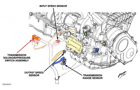

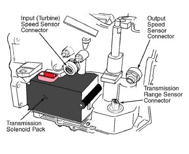

The Chrysler repair shop said I need a Solenoid pack, when I look up the part I find a control solenoid. Is this the same part identifier? Where is this part located on the transmission? What precautions need to be taken when replacing it myself? This is an LX model.

remove input sensor if u have the black cover over it remove it and the remove hold down bolts make sure all clean before the removal of the pack good luck
