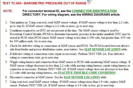

1996 Chrysler Town and Country van cuts of in idle and code
1996 CHRYSLER TOWN AND COUNTRY
106,495 MILES • 6 CYL • FWD • AUTOMATIC
VIKRAM
I cleaned throttle body and idle speed control motor pinttle and replaced new map sensor still no change, after erasing code and compliting drive cycle, code p0106 comes back, need your help.
Jan 16, 2009 at 11:22 PM
BLUELIGHTNIN6
  • 16,542 POSTS

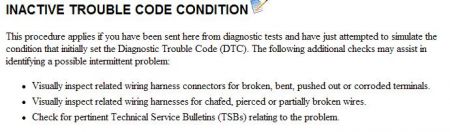

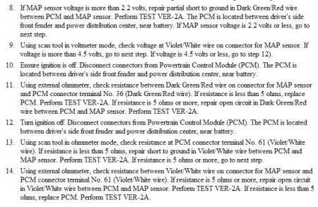

Hello Thanks for the donation. Perform following tests for engine code P0106;
https://images.2carpros.com/forum/automotive_pictures/261618_Noname_150.jpg
https://images.2carpros.com/forum/automotive_pictures/261618_Noname2_53.jpg
https://images.2carpros.com/forum/automotive_pictures/261618_Noname3_24.jpg
Post results of test and I will follow up. Thanks for using 2CarPros.com!
