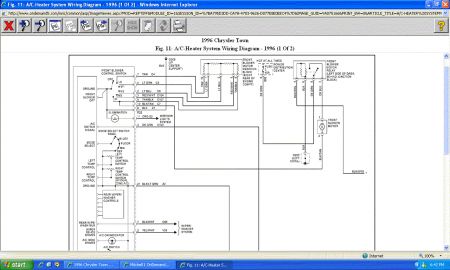

This is a 3.8L LXI. The front driver and passenger controls work perfectly. However, the back overhead vents will not blow at all regardless of what position you put the rear fan control in. The back floor vents work just fine and the rear blower works. I just can't get the overhead vents to function. My kids burn up on long trips! Thanks for your time and attention. B

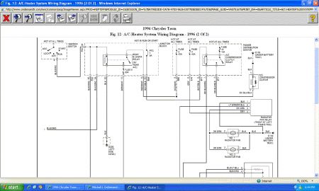

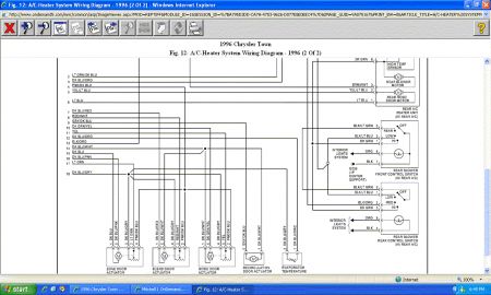

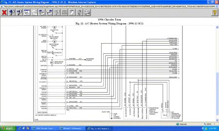

I found the actuator in the back, but the problem appears to be from the fact that there is no power whatsoever to the control knob located on the drivers side rear ceiling. Is it possible to get ahold of a schematic for this system? Where does the power source come from? I am thinking maybe a relay system? Thanks for your time. BK

If these dont work, email me and I will send it to you that way
