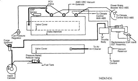

On the back of the engine there are 2 vacuum outlets there is a hose on one of them but one is missing a hose can you let me know where the hoses go

https://images.2carpros.com/forum/automotive_pictures/261618_Noname_1380.jpg

I will check to see if this diagram makes sence...I will let you know if I need more help.....Thank You
