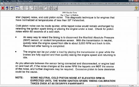

Every Chrysler 3.3 motor in the Caravan / Voyager / Town n Country has a top end rattle. Why is this?
Sunday, July 13th, 2008 AT 9:22 PM
MERLIN2021
MECHANIC
17,250 POSTS
Poor quality? Here it is right from Chrysler, to thier techs..
