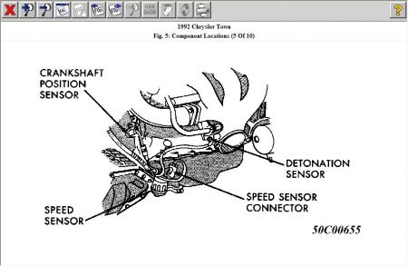

Hello mechanics,
I am quite sure that our 92 town and country van cuts out occasionally because of a bad crankshaft position sensor. However after seeing what that part looks like and also asking mechanics-and going to the junk yard and viewing stripped engines for this make and model-I still cannot locate the crankshaft position senor on my van. Question: where is it located? Thanks

If its a 3.3L engine -see below
https://images.2carpros.com/forum/automotive_pictures/12900_cps_11.jpg
