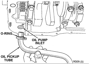

Below is the procedures-if you feel that you can't DIY then I recommend you take in and have the experts do it for you. REMOVAL 1.Disconnect battery negative cable, remove engine oil dipstick. 2.Raise vehicle. Drain engine-oil. 3.Remove oil pan screws and remove oil pan. 4.Remove screw for oil pick-up tube and remove pick-up tube. INSTALLATION
https://images.2carpros.com/forum/automotive_pictures/12900_o1_5.gif
1.Install oil pick-up tube into Chain Case Cover tighten screw to 28 Nm (250 inch lbs.) .

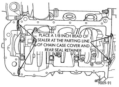

2.Apply a 1/8 inch bead of Mopar (R) Silicone Rubber Adhesive Sealant or equivalent, at the parting line of the chain case cover and the rear seal retainer.
https://images.2carpros.com/forum/automotive_pictures/12900_o3_4.jpg
