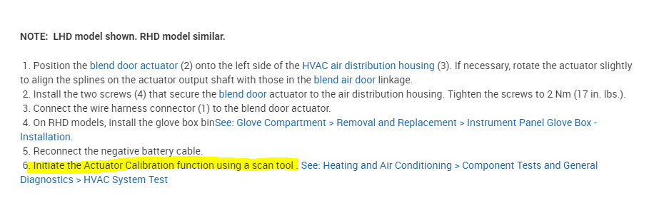

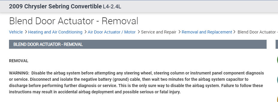

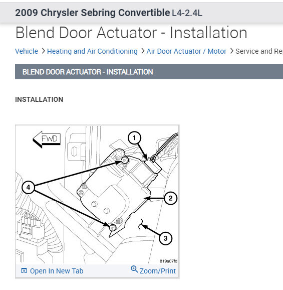

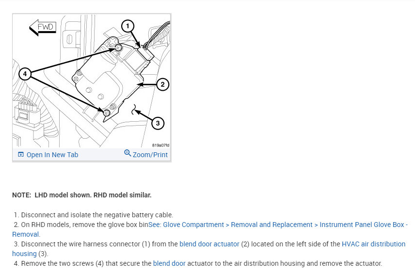

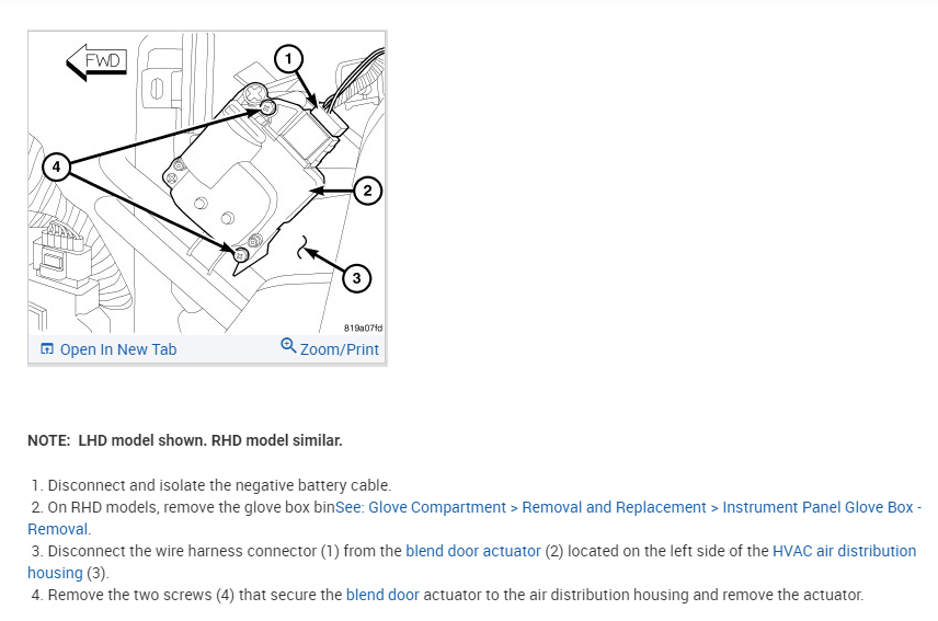

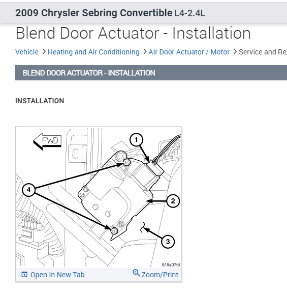

The blend air door actuator is on the left side of the HVAC unit under the dash. Once you remove it, you will be able to check if the blend door itself moves.
If you look below, I included the directions for the removal and replacement of the actuator. Take a look through them and let me know if you have questions and if it helps.
See pics below. Note: The last step indicates calibration procedures using a scan tool. Try the actuator first. If it works properly, this isn't needed. If it doesn't, this procedure will need to be done.
