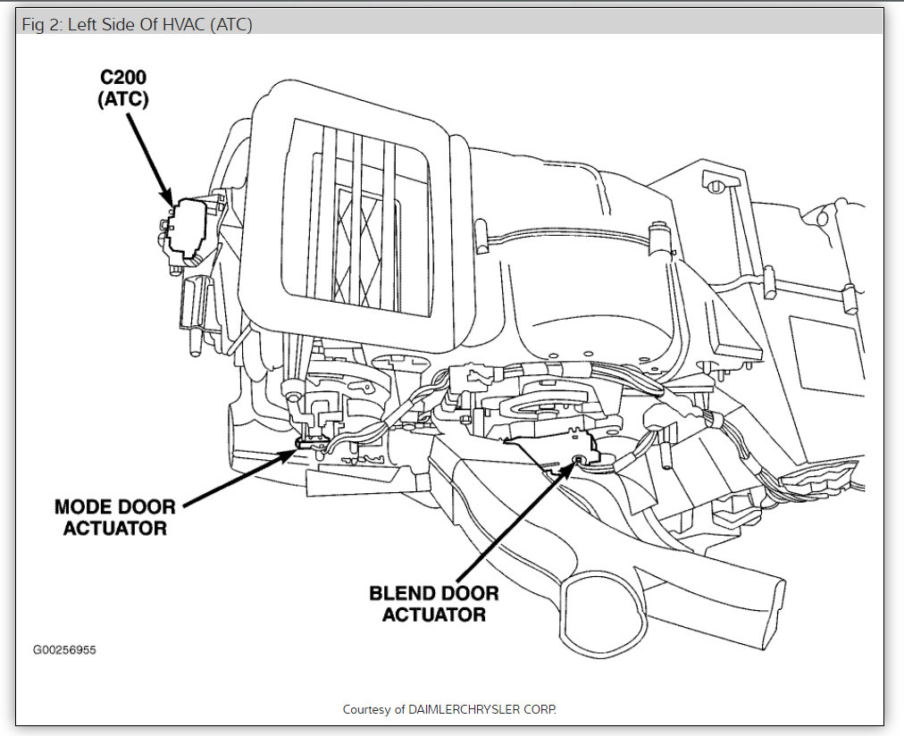

Sounds like you need to check the fuses and power and grounds to the controls. Being that either the blend door or mode doors are being controlled that is where I would start. Also look at the temperature blend door actuator here is a guide to walk you though the steps with the location for your car below.

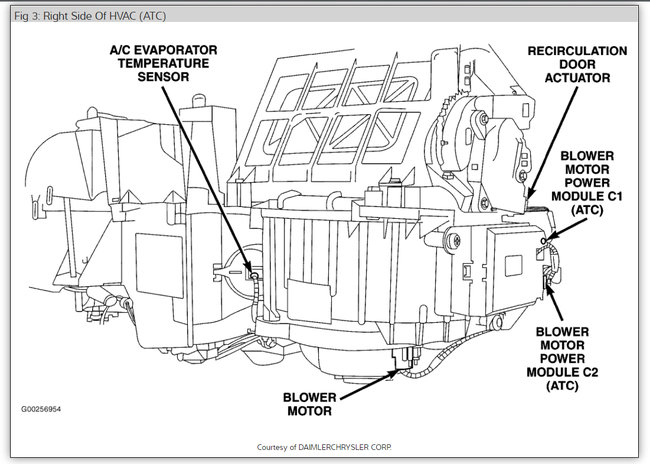

where is the air blend actuator located on a 2001 Chrysler Sebring. Please send picture if possible.
Jul 29, 2019 at 6:49 AM (Merged)
HMAC300
  • 48,601 POSTS

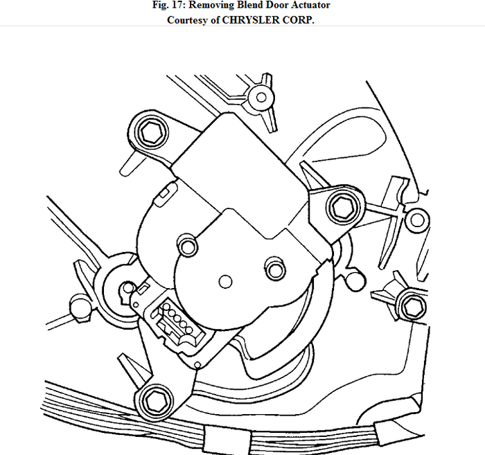

Prior to part replacement, re-calibrate HVAC actuator. Disconnecting negative battery cable for 60 seconds.
This will automatically initiate software calibration procedure.
Removal & Installation
1. Disconnect negative battery cable then remove floor console. Remove rear heat ducts. Remove the HVAC housing. See HVAC HOUSING .
2. Disconnect electrical connection. Remove actuator retainer screws and pull actuator straight down. See Fig. 17 . Note actuator shaft position for installation reference.
3. Install blend door actuator on the housing, making sure shaft spline is positioned properly with cam. See Fig. 18 . Install and tighten actuator mounting then connect wire harness connector to actuator.
4. Install HVAC housing. See HVAC HOUSING . Install rear heat ducts then install floor console. Connect negative battery cable.
Please let us know what happens so it will help others.

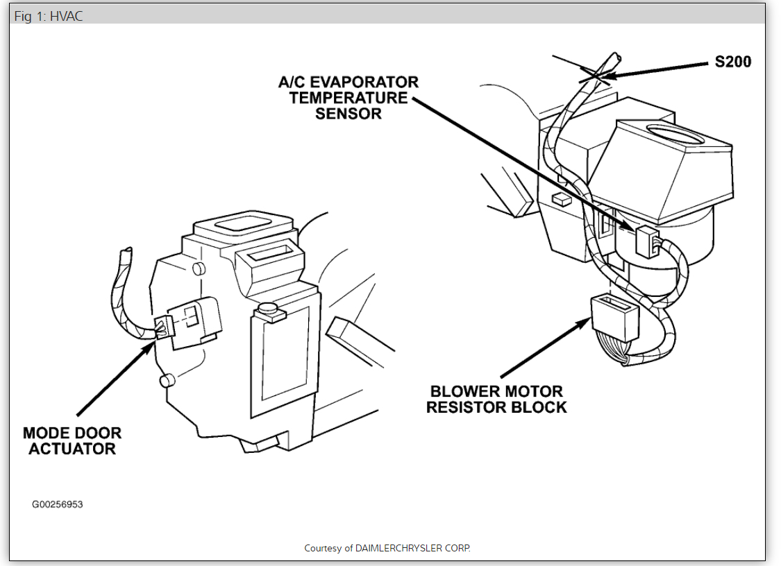

Can anybody tell me where the mode blend door actuator is? I am only getting air, hot or cold, from the defrost and floor. None from vents. Already trouble shot control module, have dash and everything else taken apart, just not sure where the actuator is. Thanks!
