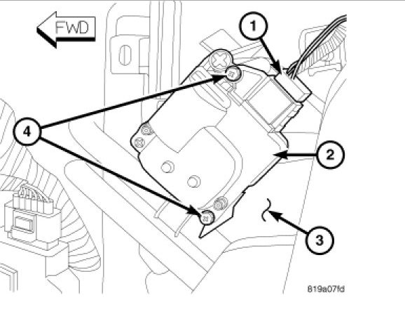

The heater is not working. The lights don't light up on the climate control the blower works but it blows out cold air and the rear defrost doesn't come on? I love this site
Nov 26, 2008 at 2:32 PM
  • 55,433 POSTS

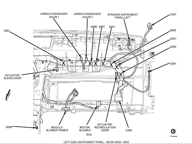

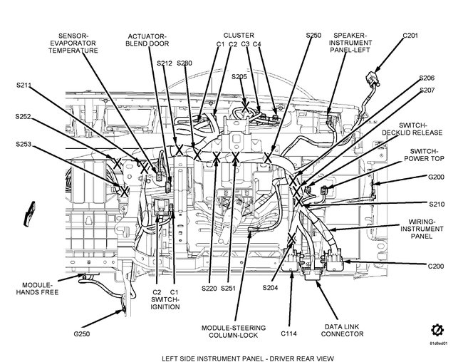

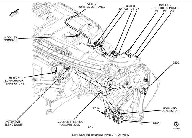

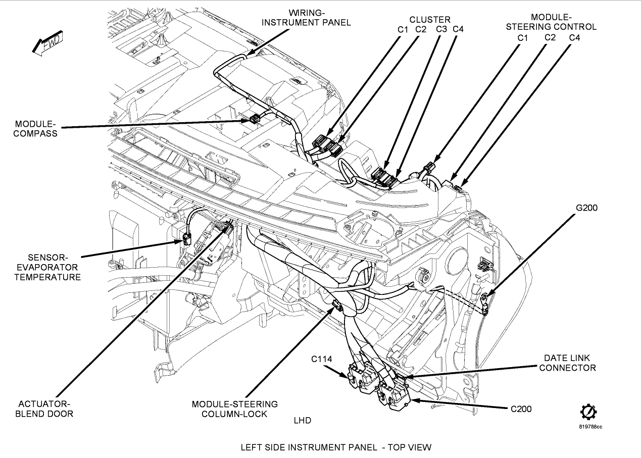

It sounds like you have two seperate problem let's address the heat issue which sounds like a temperature blend door actuator that is out and needs to be replaced. Here is a guide to help you see what i am talking about.
and
And here is where it is at on your car (below)
