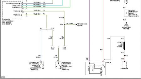

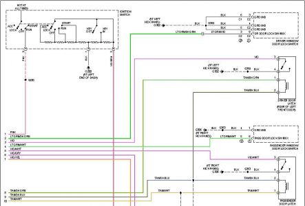

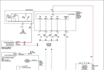

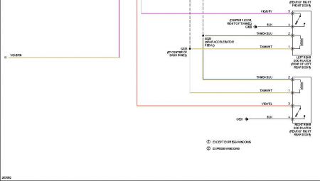

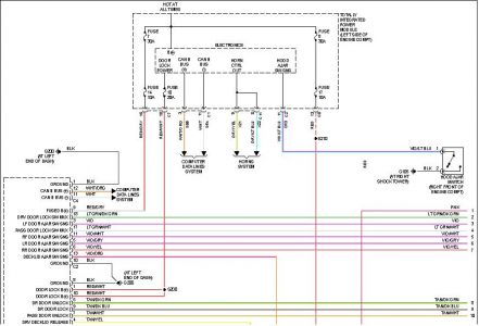

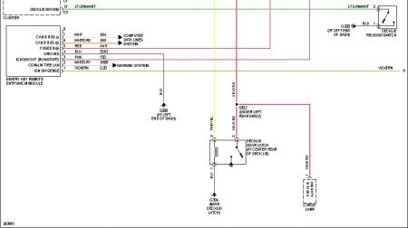

hi iam installing a remote starter in my car and i need the wiring diagrams for the starter switch and the door locks 2007 sebring sedan 4 door thanks dm

Hello and thanks for the donation! Let's see if these help..if they are too small than post your e-mail address here and I will send them to you in a bigger format..
