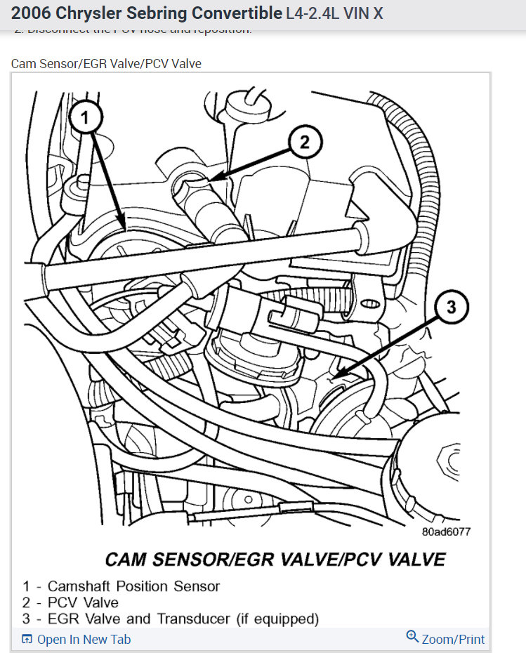

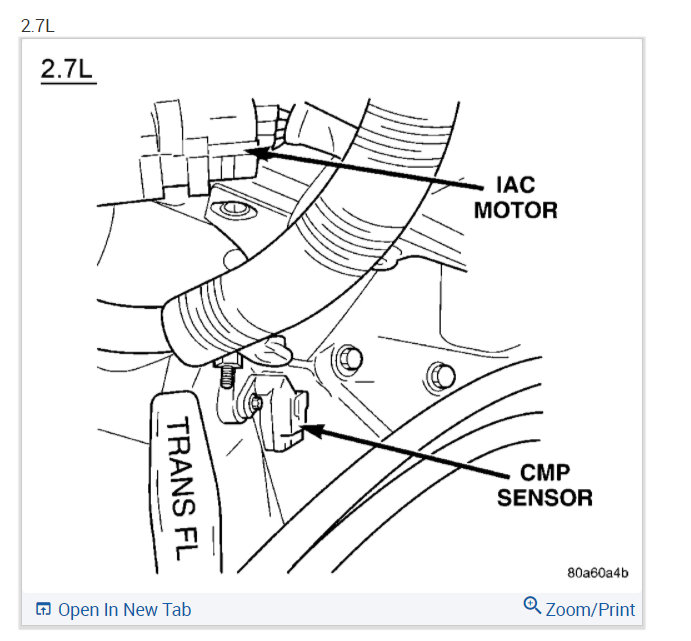

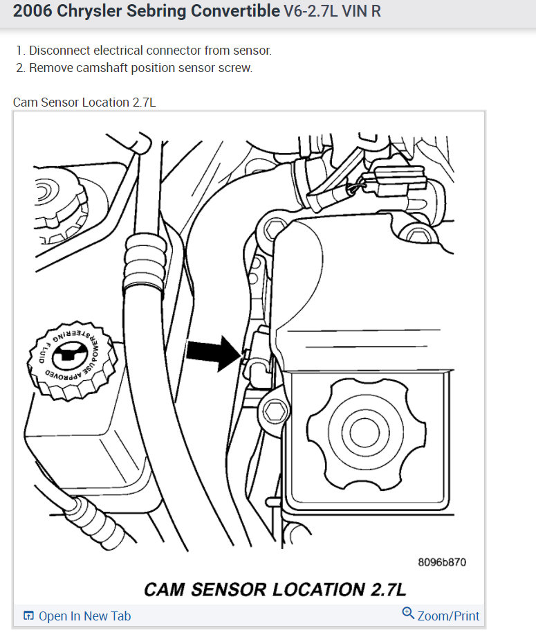

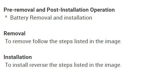

Yes you can! Here is a guide to help you step by step with instructions in the diagrams below to show you how on your car.
https://www.2carpros.com/articles/camshaft-angle-sensor-replacement
here are both engines. Check out the diagrams (Below). Let us know what happens and please upload pictures or videos of the problem.

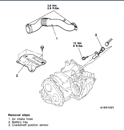

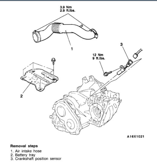

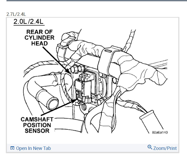

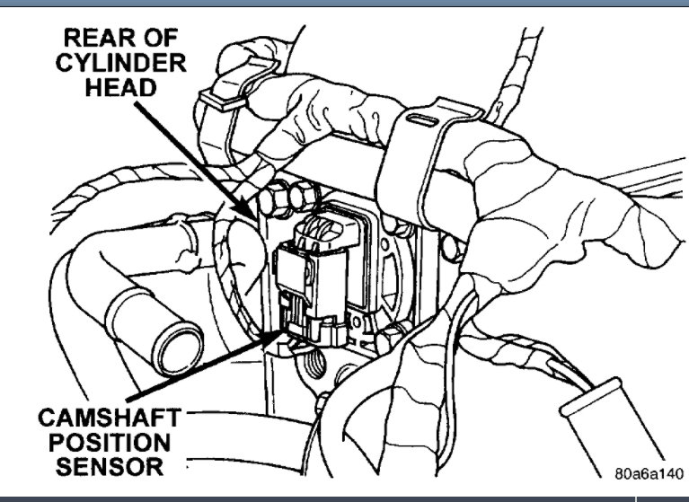

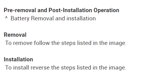

Hello, I'm Danny.
Here are 2 tutorials showing how to remove and replace both the crankshaft and camshaft position sensor:
I've attached picture steps below showing how to replace and their location on your car. hope this helps and thanks for using 2CarPros.
