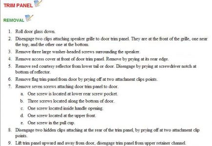

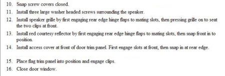

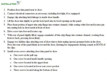

Interior problem
2005 Chrysler Sebring
remove panel
Dec 23, 2009 at 10:46 PM
BLUELIGHTNIN6
  • 16,542 POSTS
https://images.2carpros.com/forum/automotive_pictures/261618_Noname_1332.jpg
https://images.2carpros.com/forum/automotive_pictures/261618_Noname2_400.jpg
https://images.2carpros.com/forum/automotive_pictures/261618_Noname3_150.jpg
https://images.2carpros.com/forum/automotive_pictures/261618_Noname4_73.jpg
