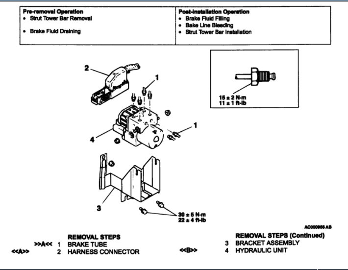

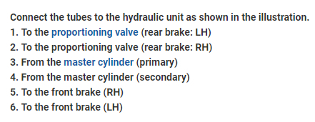

When hooking up my trailer brake controller I found the ABS module was bad.
Thanks, Jim
Jul 12, 2009 at 1:44 AM
DANNY L
  • 5,648 POSTS
Hello, I'm Danny.

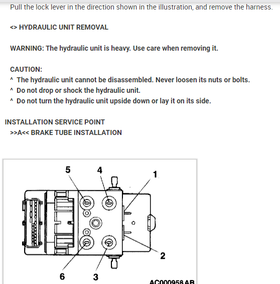

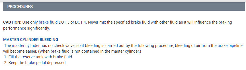

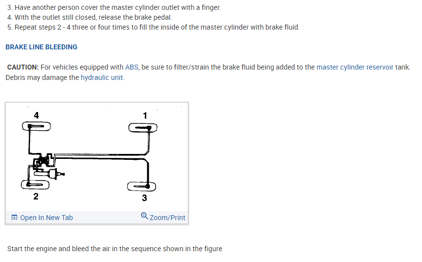

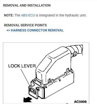

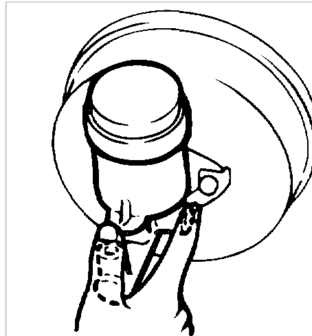

Here is the information you requested. I've attached picture steps below on how to change the ABS hydraulic unit on your car below. I've also attached brake bleeding steps and here is a tutorial to view as well:
https://www.2carpros.com/articles/how-to-bleed-or-flush-a-car-brake-system
Hope this helps and thanks for using 2CarPros.
