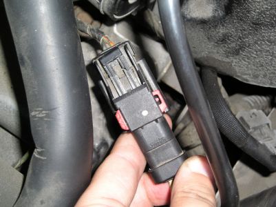

Hello everyone. My name is Melanie, and I'm currently an automotive mechanics student in her early years of training. I have a 2004 Chrysler Sebring Limited convertible with a 2.7L engine, and it needs a new Camshaft Position Sensor. I just picked the part up from the dealer, but now I'm having problems getting the old sensor detached... it has some kind of clip system, and I am unsure of how to get these off without damaging the car. I will post a picture below of the type of sensor it is if it will help... this is not the cam sensor itself, but it was too hard to get a picture of.
[img:38389a8147]http://www.2carpros.com/forum/automotive_pictures/97890_sensorclip_1.jpg[/img:38389a8147]
Can anyone help me take these clips off? I feel like it's such a silly question, but I really don't know!

hi meliane looking at the the plug,u will c on the right of picture u show the red clip has a small tab in middle useing something sharp like a scribe ,pen ect,push the little tab either way easly youll feel it when its in right dirrection then from left pull out red clip agian might need spmething with a edge,hope this helps,if not ask me agian
