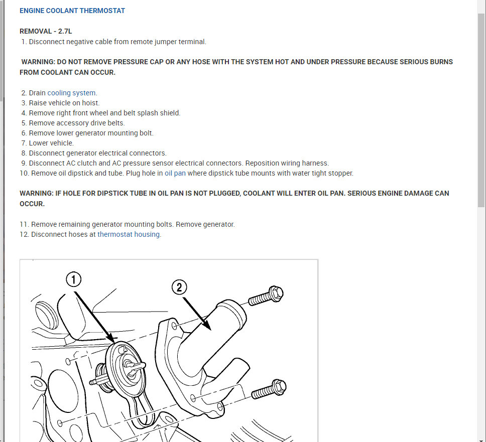

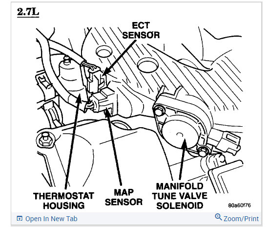

Can you tell me where the thermostat is located on my 2004 Chrysler Sebring 2.7Ltr engine?
Monday, July 7th, 2008 AT 10:37 AM

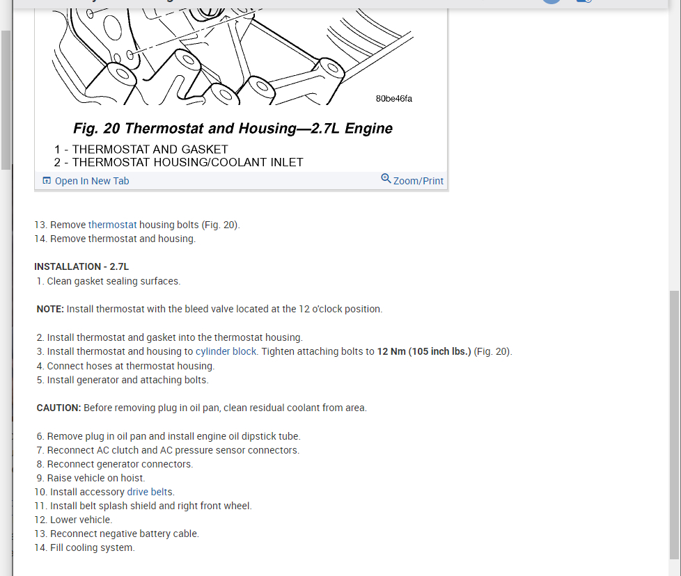

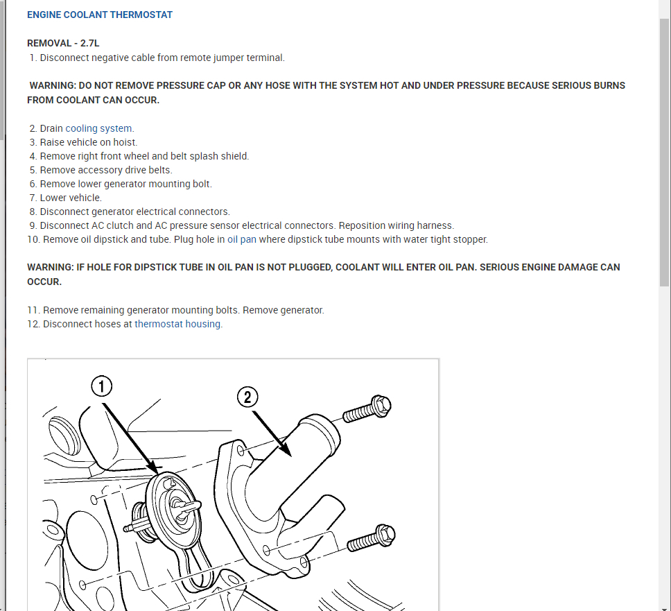

Sure can. Here is a guide that will help with replacing a thermostat as it includes some good info that the manual does not have:
Also, below is the info from the manual that will provide the info needed to complete this including the location of the housing which clearly has the thermostat inside.
Please run through this material and let us know if you have other questions.
