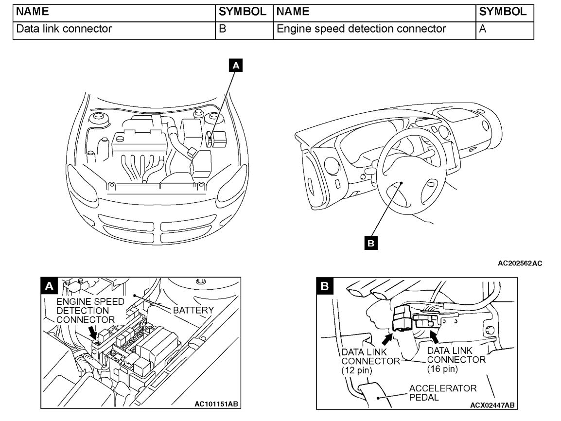

where is the plug for the on board computer so I can plug into it??
Apr 13, 2009 at 6:11 PM
  • 75,992 POSTS
Behind lower left of dash
See the diagram below
Apr 13, 2009 at 11:03 PM
SPARKY7154
I thought it might be there , but I did not want to pull part of the dash to get at it.. The dash and pading go all the way to the fire wall... did not know what part of the dash to pull.
Apr 14, 2009 at 6:22 AM
SOS032781
There are screws attached to the dash... and some wirings also, be careful in pulling the the dash...
