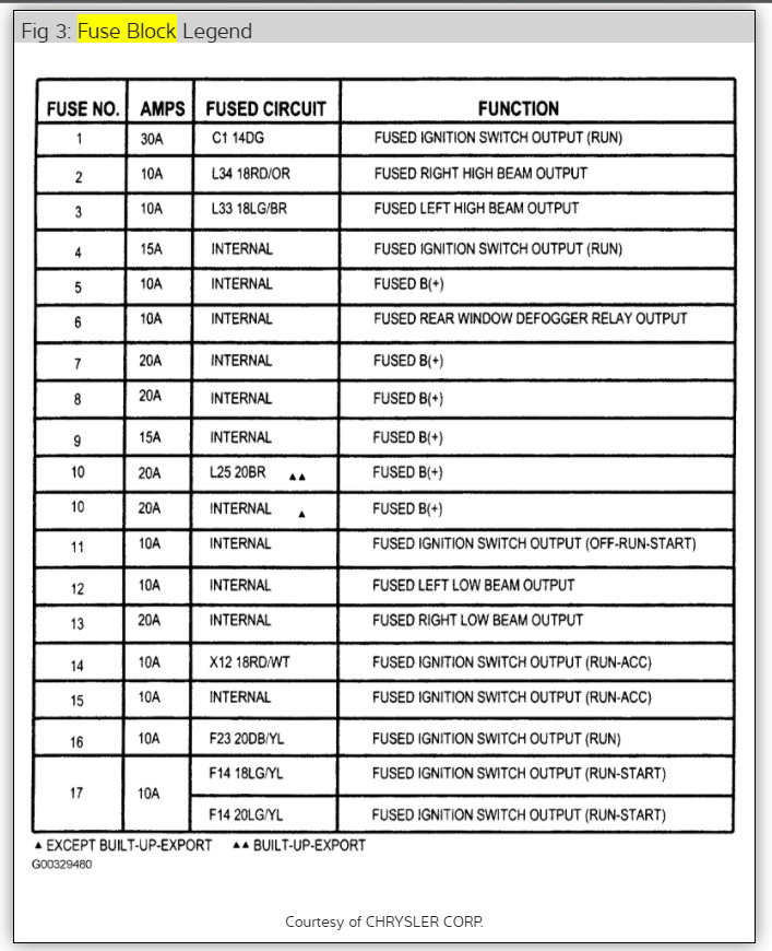

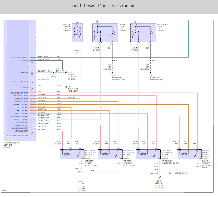

About a month ago my power locks stopped working on my doors on both sides. I move the switch up and down on both sides and nothing happens. I don't think its a fuse because my power windows still work. What else could it be?
Nov 2, 2010 at 2:09 PM
  • 55,433 POSTS

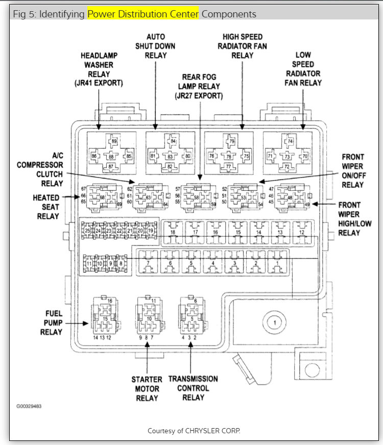

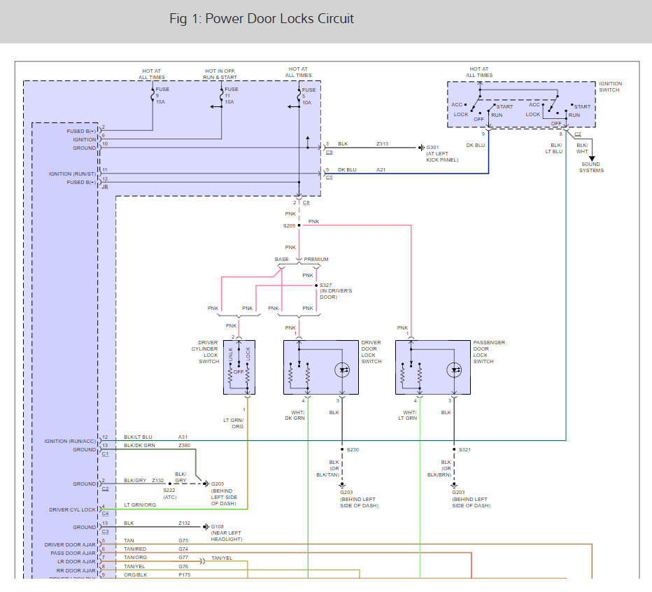

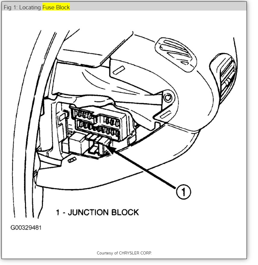

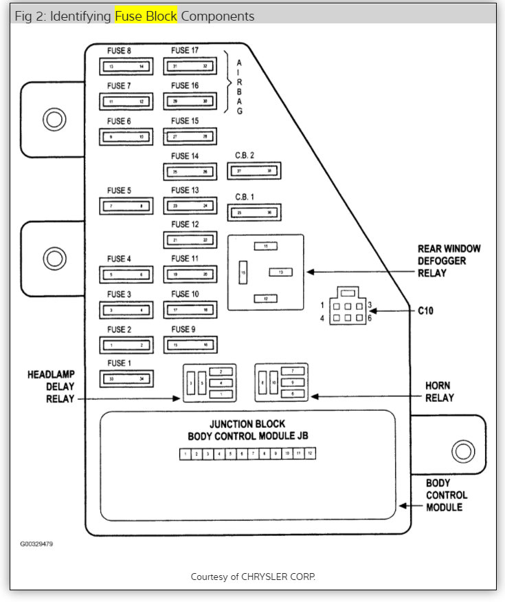

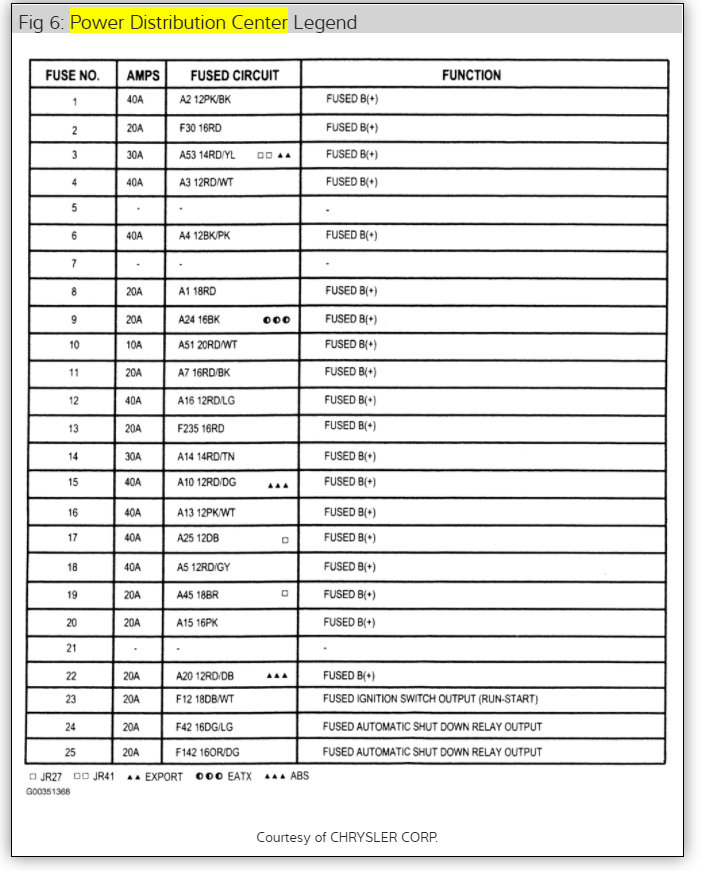

It sounds like it could be a fuse becasue there are three that run the system. #5, 11, 9
Here is a guide to help you test and replace the fuse.
Here are the door lock wiring diagrams and fuse panel locations (below)

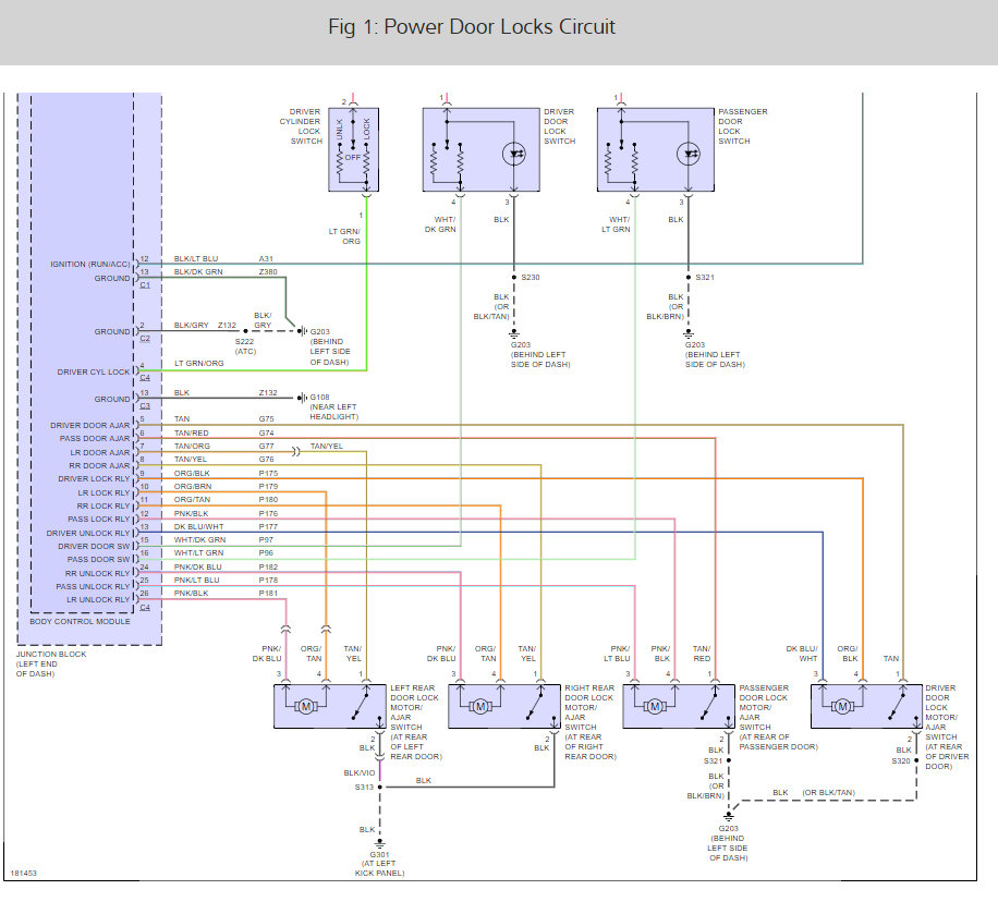

You will need to start tracing out wires and circuits and figure out where the short it. You will also need to get the leaking top addressed as well.

Let me know any sub-model information/trim level and the real size of the engine and I will grab some schematics for you.

Start by checking the fuses. The radio's memory circuit can be tied in with the locks, interior lights, or some other circuit that is always live. The power locks will not lock when the doors are open.
