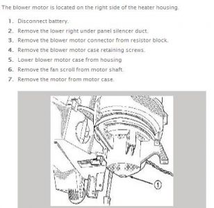

The blower motor works intermittently. If I tap the motor when it doesn't start, it generally comes on. I know where it's located and it looks as if it should be easy to remove, but there doesn't appear to be enough clearance to get it completely out. Any advice on how to remove it?

Hello, I came across the above info. Sometimes I don't follow the info in the databases. If I see a better way, I do what's easiest for me, as far as removal and installation.
