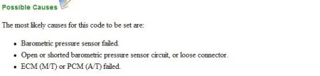

I need to narrow down a diagnostic code on my car the code is P0106 the code could be one of three things. a bad map sensor a damaged vacuum hose or a throttle position sensor at least that is what my research tells me. my car will drive when it is cold b ut once i drive it for 15 minutes it will stall out Ex. at a stop light but if I let it sit fot a while it will fire back up but it has been a everyday occourence
Apr 21, 2009 at 12:21 PM
BLUELIGHTNIN6
  • 16,542 POSTS

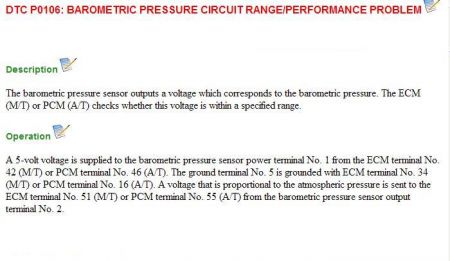

What engine size and trim is it? (coupe/convertible 2.5L / 3.0L etc...?) Below is info. about this trouble code for the 3.0L Coupe..
https://images.2carpros.com/forum/automotive_pictures/261618_Noname_474.jpg
https://images.2carpros.com/forum/automotive_pictures/261618_Noname2_126.jpg
Please specify info. I asked for so I can ensure the trouble code details I posted are the same for your make and trim as well.. Thanks for using 2CarPros.com!
