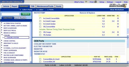

2003 Chrysler Sebring Please tell me no
DOCHEAT
  • 2003 CHRYSLER SEBRING
  • 6 CYL
  • FWD
  • 120,000 MILES

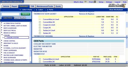

First, The car heater stopped working. I took it to the shop, I asked if it could be thermostat. They flushed the system. Now the heater works and it is leaking water. Can you tell me how much it would cost to replace the water pump. I already bought the pump and thermostat. I just want a ball park estimate.
Sunday, February 28th, 2010 AT 4:15 PM
  • 75,992 POSTS
Labor rate per hr ranges from $70.00-$130.00 and varies with location.
