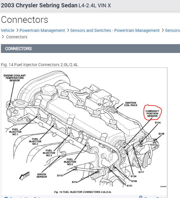

Camshaft position sensor where is this located?
2003 CHRYSLER SEBRING
106,000 MILES • 4 CYL • 2WD • AUTOMATIC
MIKEV009
Where is this located?
Sep 19, 2009 at 9:29 AM
SQM
  • 6,383 POSTS

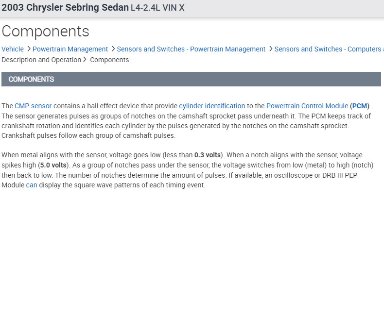

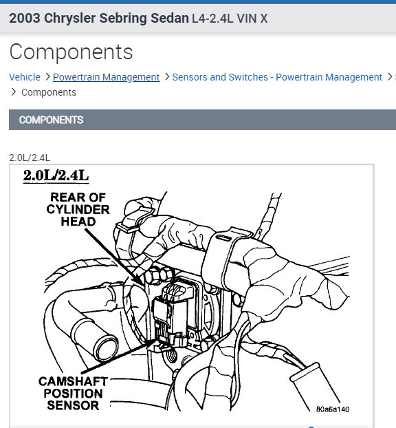

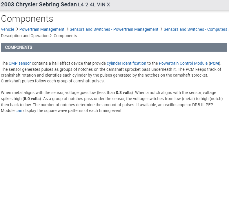

The camshaft position sensor is located on the right-hand side of the engine (if you are facing the engine), at the end of the cylinder hear.
https://youtu.be/hqEgqodE_-8

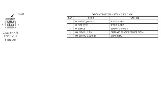

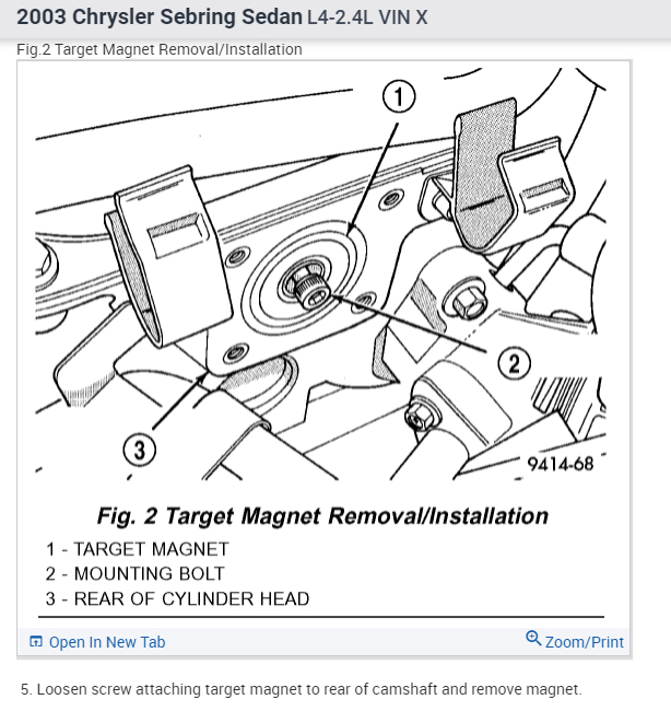

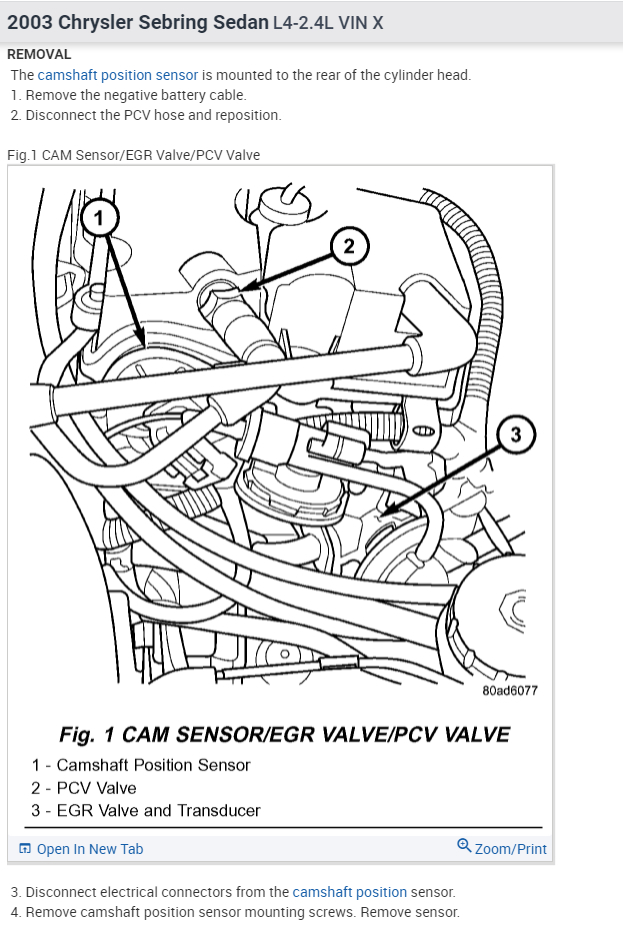

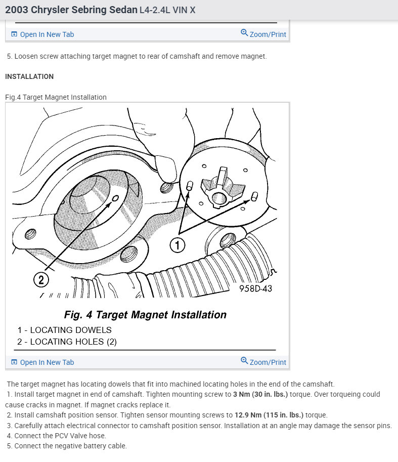

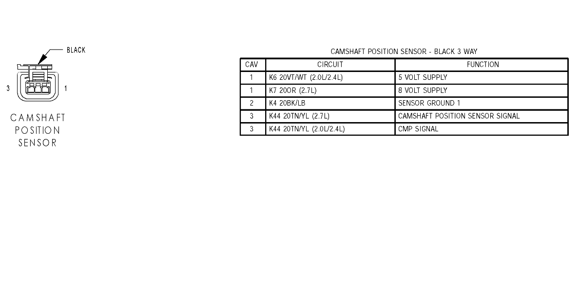

I have attached diagram and replacement procedures below.
