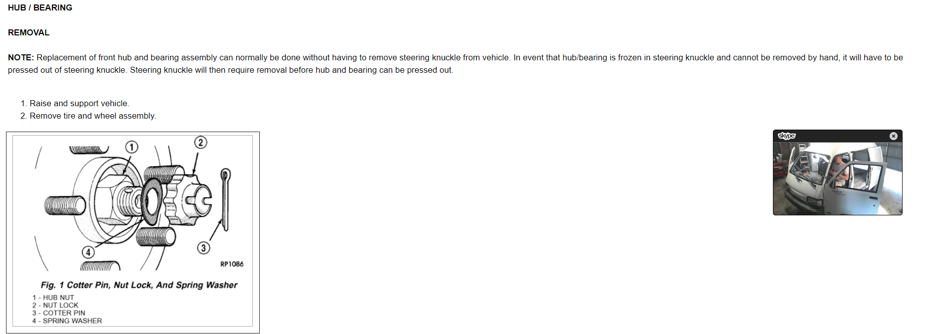

Noises problem 6 cyl Front Wheel Drive Automatic 86,000 miles
When i am driving about 40-55 a light howling noise comes from what it seems to be the engine its really light but you can hear it then it comes back when its about 65-70 mph then the noise seems to go away
Nov 13, 2009 at 2:43 PM
  • 55,809 POSTS

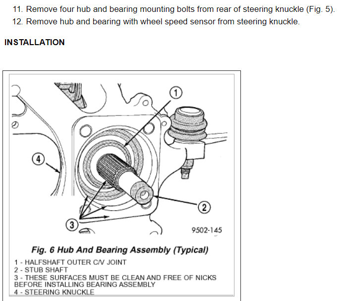

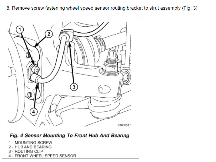

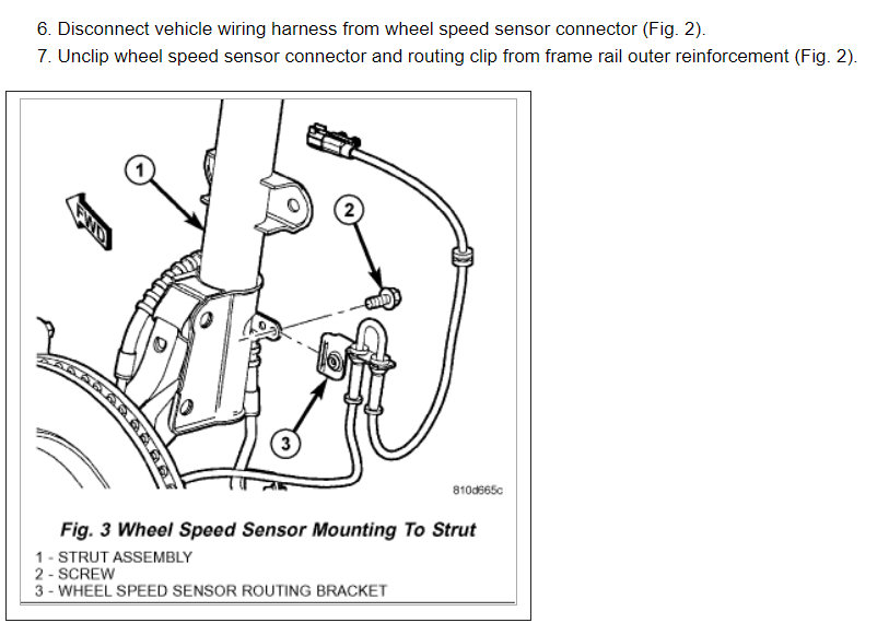

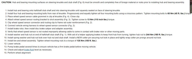

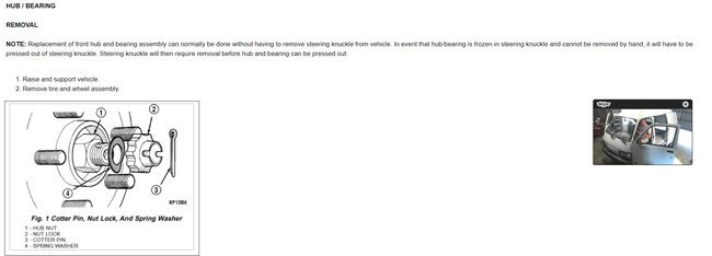

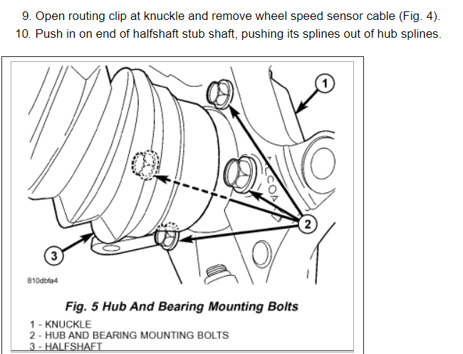

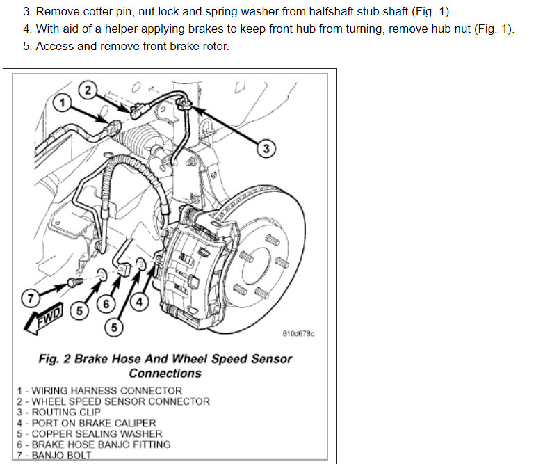

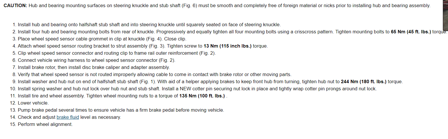

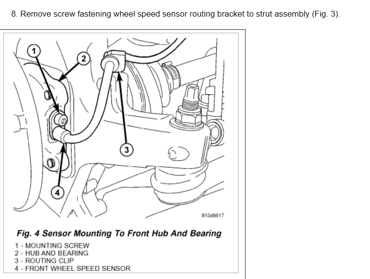

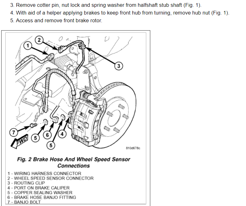

This sounds like you have a front axle bearing that is out and needs to be replaced. Here is a guide to help you see what you are in for when doing the job.
https://www.2carpros.com/articles/how-to-replace-a-cv-axle-bearing
Here are diagrams of what you got on your car (below)
