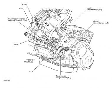

2002 Chrysler Sebring 6 cyl Front Wheel Drive Automatic
My Sebring had a transmission leak at the solenoid pack. The garage I took it to for repairs said the pack must be replaced. I had thought that since my transmission was otherwise operating normally, the solenoid could be reattached with a seal kit.
What would be normal proceedure in this case? Replace the solenoid pack or reseal the original unit?
Feb 6, 2009 at 8:00 PM
ZACKMAN
  • 4,202 POSTS
You can get the seal from the dealer (the only place). There is no reason to replace the pack if the transmission is shifting properly.
https://images.2carpros.com/forum/automotive_pictures/55316_02sebringtcm_1.jpg
