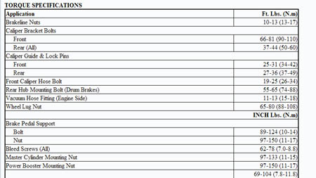

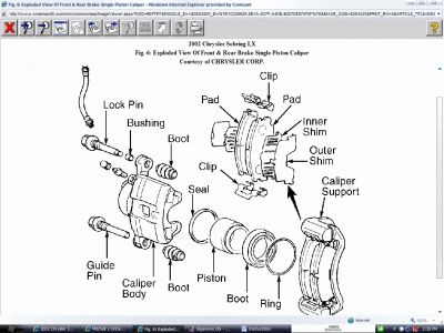

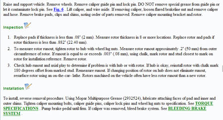

How do I remove the front Calipers to get to the Pads? The removal of the Rear was simple and when I tried to do the Front I had no idea where to start. Is there some kind of picture you can e-mail me so I can have a visual of what to remove?

Remove the two caliper pins, then the support bracket.
