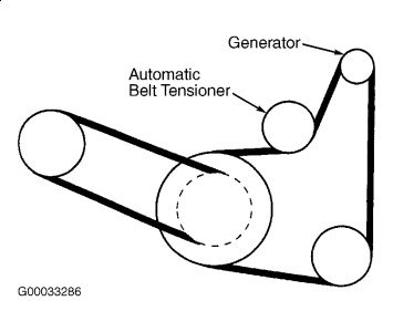

i have a sebring lx, 2.4L sedan which uses 2 belts. exactly how do i change these belts? any help would be appreciated

PS belt is the outer one. Loosen 2 bolts behind the pulley, and another bolt on the other side of the PS bracket. Locate 1/2" square hole to loosen the tension. Loosen the tensioner bolt on the alt belt to remove. Install is reverse.
