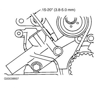

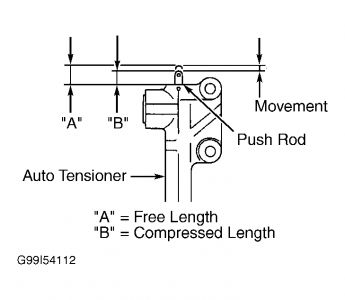

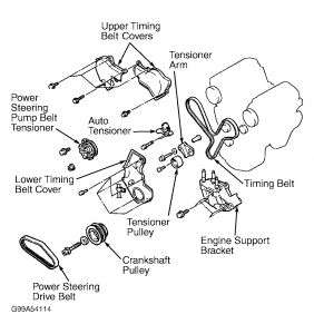

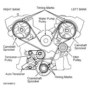

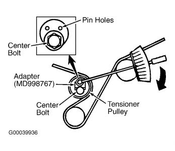

v6 3.0SOHC
https://images.2carpros.com/forum/automotive_pictures/99387_1_35.jpg
https://images.2carpros.com/forum/automotive_pictures/99387_2_15.jpg
https://images.2carpros.com/forum/automotive_pictures/99387_3_11.jpg
https://images.2carpros.com/forum/automotive_pictures/99387_4_7.jpg
https://images.2carpros.com/forum/automotive_pictures/99387_5_2.jpg

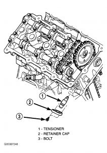

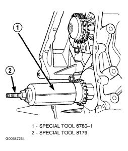

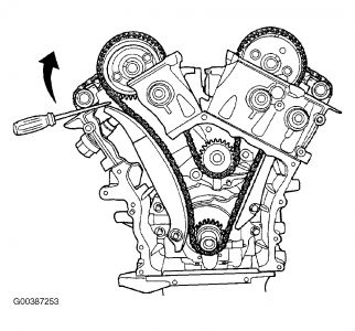

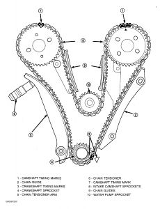

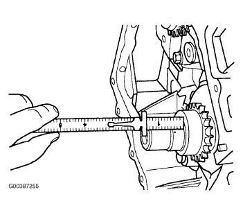

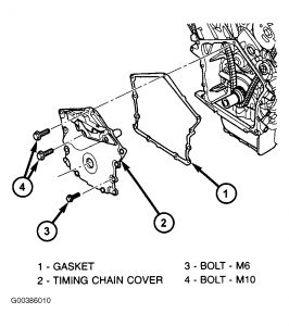

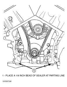

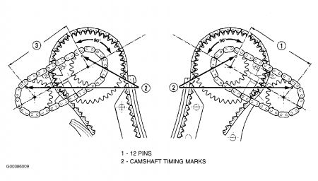

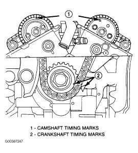

V6 2.7L
https://images.2carpros.com/forum/automotive_pictures/99387_1_36.jpg
https://images.2carpros.com/forum/automotive_pictures/99387_2_16.jpg
https://images.2carpros.com/forum/automotive_pictures/99387_3_12.jpg
https://images.2carpros.com/forum/automotive_pictures/99387_4_8.jpg
https://images.2carpros.com/forum/automotive_pictures/99387_5_3.jpg
https://images.2carpros.com/forum/automotive_pictures/99387_6_2.jpg
https://images.2carpros.com/forum/automotive_pictures/99387_7_2.jpg
https://images.2carpros.com/forum/automotive_pictures/99387_8_2.jpg
https://images.2carpros.com/forum/automotive_pictures/99387_9_2.jpg
