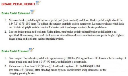

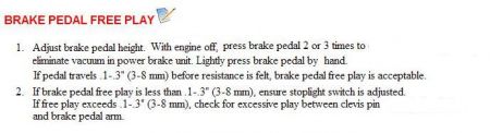

I have replaced my master cylinder on a sebring 2001. Is there any way to adjust free play on the brake pedal by way of spacer, etc.?

https://images.2carpros.com/forum/automotive_pictures/261618_Noname_1138.jpg
https://images.2carpros.com/forum/automotive_pictures/261618_Noname2_328.jpg
